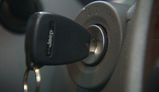

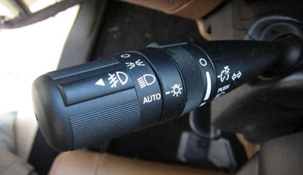

Step 2 – Manipulate key and headlights
Insert the key in the ignition, but don't start the vehicle. Turn the key to the "ON" position, then turn the headlights on and back off. Turn the key off. The ECU will be reset to factory settings at this point. Over the next 50 warm-up periods, the ECU will gather the necessary information involving your driving habits and the parts installed on the vehicle.
  • Figure 2. Turn the key to the "ON" position.
  • Figure 3. Turn the headlights on then off, and remove the key.
