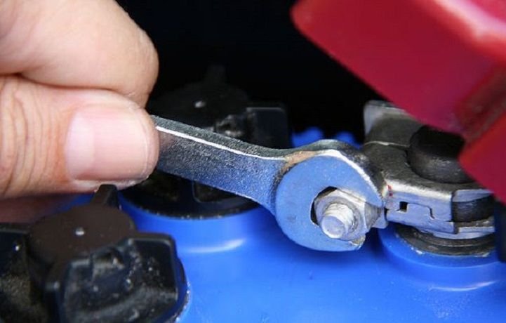

Step 1 – Remove the positive (red) battery cable
Use your wrench or ratchet to remove the positive battery cable. Only remove the positive cable. Leave the negative cable in tact.
Figure 1. Remove the positive (red) battery terminal only.

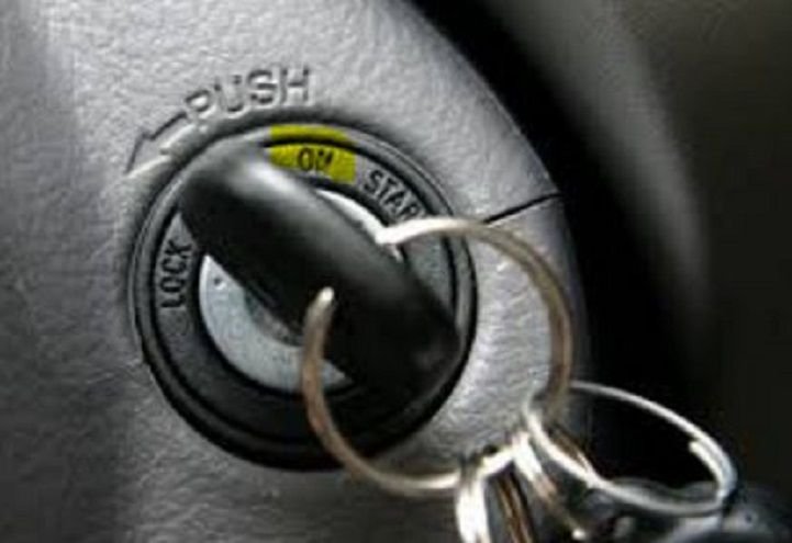

Step 4 – Turn on your Jeep
  • Insert your key into the ignition.
  • Turn the key to the "ON" position.
  • Do NOT start the engine.
Figure 4. Insert the key and turn it to the "ON" position only. Do not start your Jeep.
