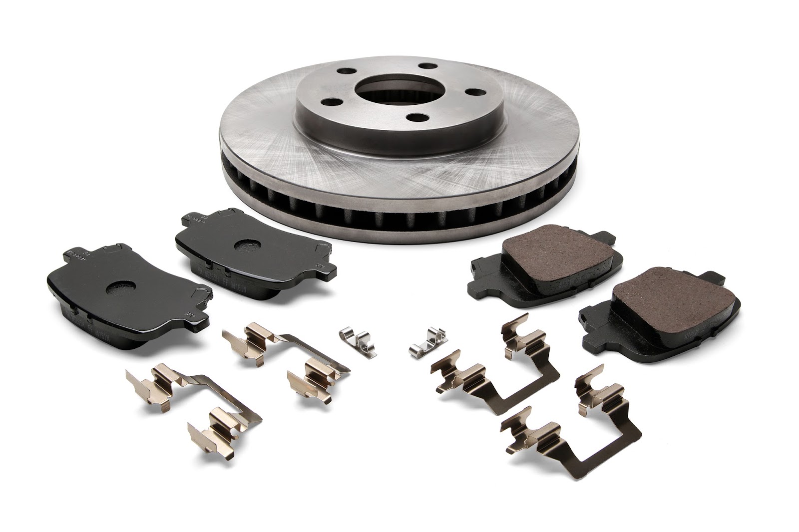

Brake bedding is the process in which you transfer some of the brake pad material to your rotors to ensure even rotor engagement from your pads. You know when you add a new set of pads to your calipers and you get some brake “judder”? That’s usually a signal that the pads have not been bedded in properly. If you don’t know what that is, but you’ve had a brake rotor that has “warped”, then you’ve felt something like brake judder. Brake bedding will also help reduce brake glazing on the pads and rotors. Brake glazing increases your stopping distance, so say “no” to the glaze.
