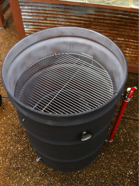

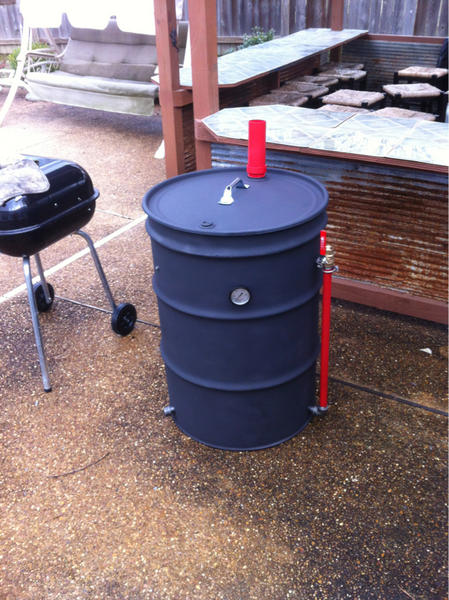

Time to season this baby up and get ready to cook!!

You're both correct!!! It's a very efficient smoker that's easy to build, and pretty darn cheap too. Unfortunately they're also pretty ugly on the porch, hence the name.

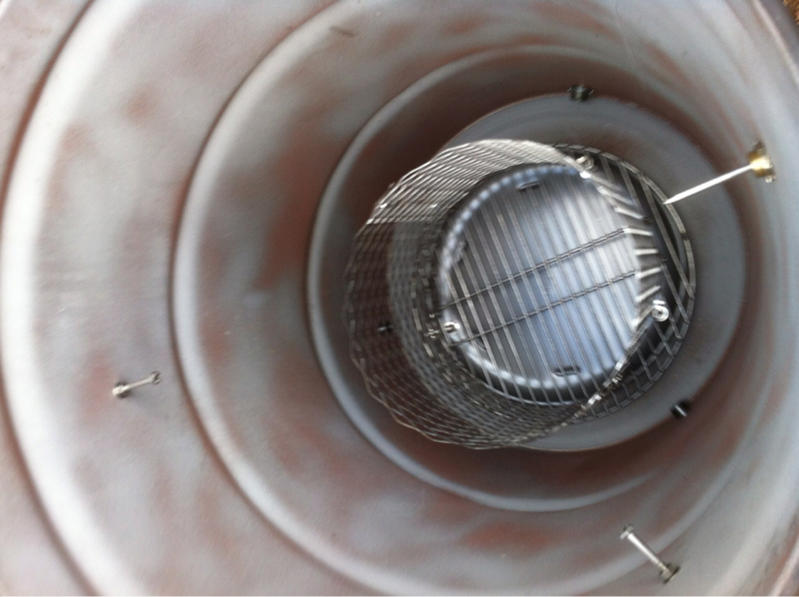

I finally put an oven thermometer on the grates, mine was closer to 40 degrees off, I may try putting a pizza pan on my basket for a diffuser, I really like the length of time it will hold temps, I just need to figure that baby out.

Ok, tried an airflow pizza pan today. Just sat it on top of my charcoal basket, worked awesome. Much more even temps across the grate. I suggest giving it a try.
