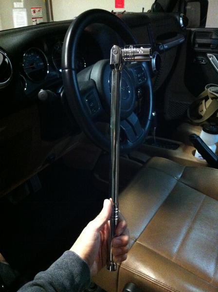

So I used a 15" Breaker Bar...and as the others mentioned in previous posts, no struggle to get the bolts off. Just thought I'd add a picture for anyone looking for a quick reference:

I used a pipe in the end off the ratchet and it worked perfect
