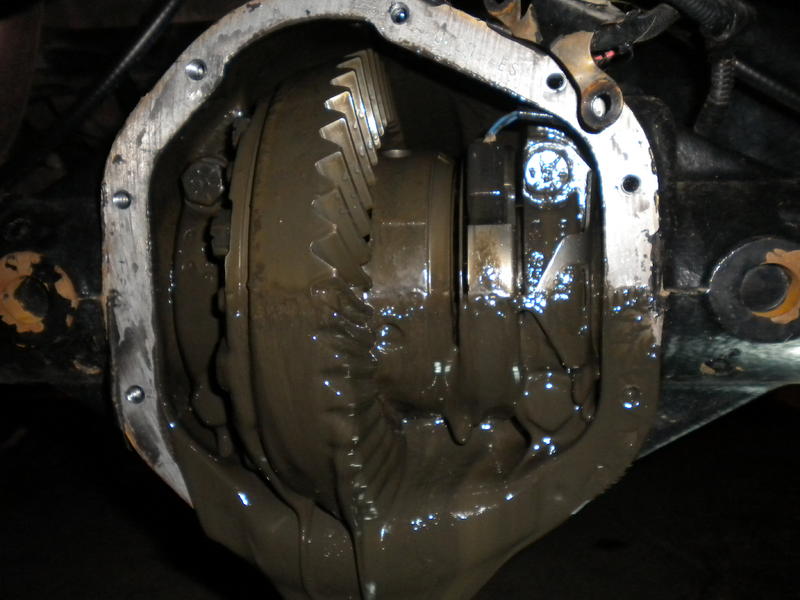

1. $190 dollar diag bill
2. $120 dollar flat rate shipping bill for jeep
3. $1000 dollar axle shipped brand new with 18 miles on it
Estimated total: $1400 dollars
Jeep wanted to charge me 2700 dollars to fix my rear diff and that was not even a guarantee it was going to fix the problems... here is what the inside of my rear diff looked like!!!
Attachment 266980
Keep the actual carrier, I want to see it.

once i tear into the rear axle after the new one is in i will let everybody know the exact problem which caused the failure

Currently what i believe happened was the pinion seal was leaking before the last wheeling trip... i knew about it and was going to replace the next weekend which would have been well tomorrow... well I believe this is where I got water into my diff and with that the pinion seal completely started to fail because on my way to work in the morning it started making a humming noise i knew something was not right.. got to work and said alright on the way home if it is doing it again its going straight to the shop... on the way home it started to get worse and then when it down shifted to 1st gear it made a clunking noise and felt like the trans was slipping... I was talking to cj that went jk the whole time we were talking things through to test... i got close to the jeep dealership and got the aroma of gear oil i was like shit not good i am going straight to the dealership which was very very close to where i was. pulled into the dealership got to the parking lot going about 5 mph in first gear boom!!!! (FYI i have an automatic) loud noise that was my rear drive shaft falling off but it did not break ... with the vibrations and what not with the pinion bearing going bad it loosened the pinion nut off the pinion... which mind you was put on with 300 fps of torque!! but no lock tight... well when when the drive shaft came off it locked up the rear axle and it was done for.... tried to throw it in 4wd and drive forward no luck the rear tires would not move.... but the goofy part is they were able to drive the jeep in reverse with no problems....
that is my diagnosis from what i have seen so far...

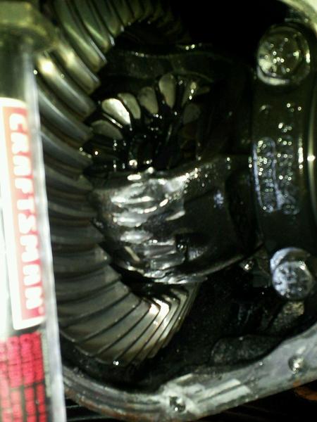

I had the same thing happen to me when I got some water in the rear diff. i got lucky when i heard it coming home from the badlands. I took the rear driveshaft out and drove home in 4wd. Same exact thing just less catastrophic. Hear was a pic of my diff. Also if you need any parts for the rear let me know. I am installing 4.10s and an arb in my jeep now.
