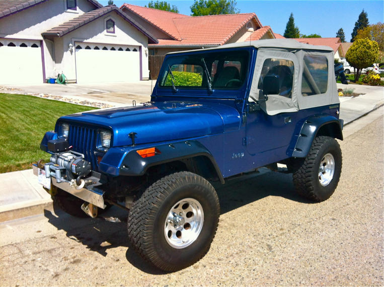

The factory carter carb in those are notorious for acting wonky. If your starter & solenoid are fine, then check your vacuum lines like suggested. If the lines are fine, it's probably your carb acting up. My 87 used to die at red lights or Stop signs. Cleaning the Venturi solved this problem for me. If you google it, you'll find some good step-by-step instructions on cleaning your Venturi assembly inside the carb and/or you could rebuild your carb with a kit as well if you want.
Best long term solution would be to swap the carter with a Howell or MPFI system, but that gets expensive. Loved my 87 & was sad to sell it, but I needed the extra money.
