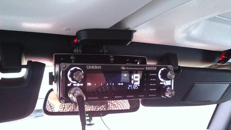

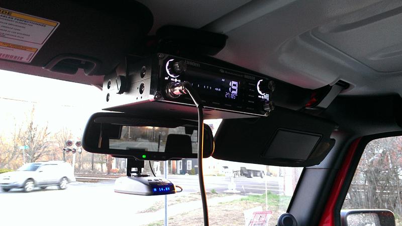

ID:	450312Click image for larger version

Originally Posted by wolfgang239
With that location does the CB interfere with the rearview mirror at all? That's the first one I've seen there on a 13, and was worried about the mount being in the way of the mirror.
Old Apr 24, 2013 | 02:25 PM
  #25
BlackRockBurner's Avatar
Posts: 1,186
From: Vallejo, CA
I think it depends on your height and how high you have your seat. The first picture shows a clear rearward view from that camera /eye level angle.
Old Apr 26, 2013 | 02:32 AM
  #26
wolfgang239's Avatar
Joined: Apr 2013
Posts: 32
From: Somerville, MA
I tried to capture it roughly from my driving position. As BlackRockBurner points out, it worked for me but you might want to have someone hold it up there for you as a test. You can look up the dimensions of my radio (Uniden 980) to get an idea as to what will fit up there. With the coax connector sticking out this radio is as big as you can go. A right angle connector might buy you some more room but the power cable on many radios sticks out too, another consideration.

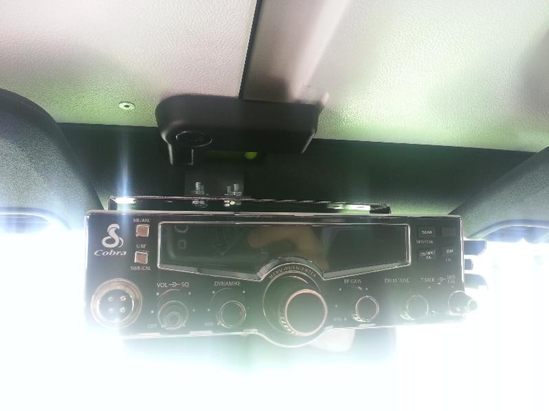

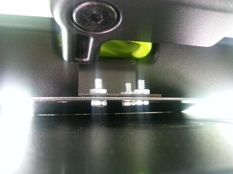

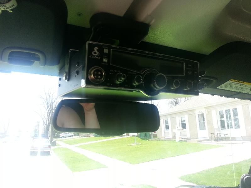

Got mine from strikeforcezebra.com it attaches the the loop above the rear view unfortunately in my 13 my radio is bigger so it interferes with my rearview so my rear view is looking at mt back seat :(
ID:	451668   Click image for larger version
ID:	451669   Click image for larger version
