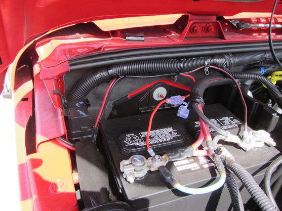

Originally Posted by rodi
So, between the cb and the battery, along the same positive line, there should be two fuses? One at each end?
Basically, yes. The one near the battery protects the Jeep, the one near the CB protects the CB.
Here's a pic with a fuse holder near the battery:

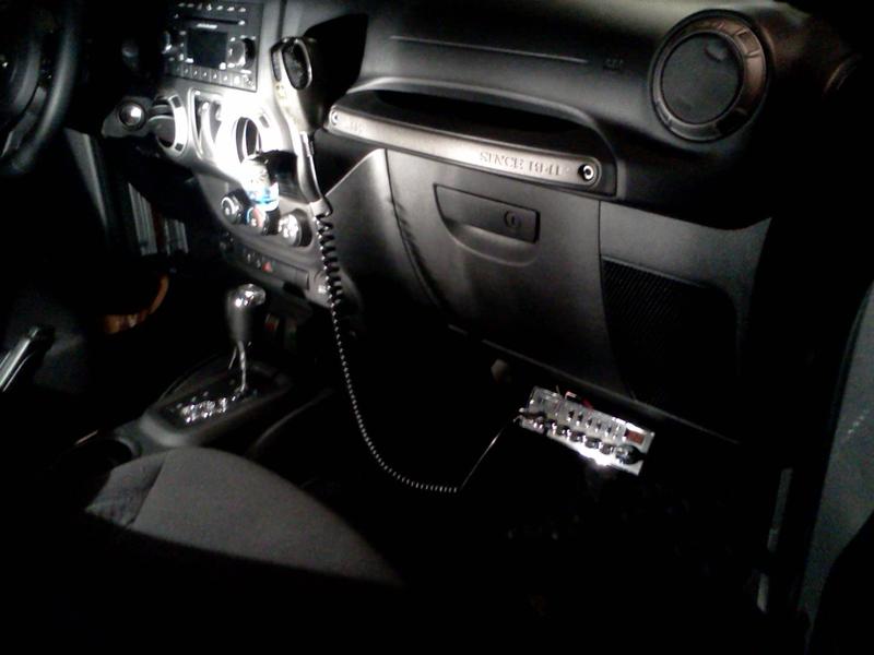

Default Here's where I mounted mine.
It's an Army Edition Cobra 29 LTD but I'm thinking about selling this CB for a different model.
