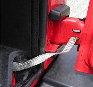

Running braided ground strap was part of my initial install plans, but I checked my antenna before I put it on. High SWR!! Bonding the gate resulted in a 1.2:1 SWR or less across all 40 Channels, no trimming necessary. You can run the bonding strap through the same holes the the plastic trim piece uses to clip in.

I didn't feel like pulling everything apart. Here are 2 pictures of how I routed it. Finding the bolts on either end is easy, once you have the plastic covers off just find a bolt and scrape some paint.
I've had about 4 or 5 other CBs and never had a problem with high SWR till this one. I have my antenna mounted on a bracket on my gate to the tire holder. I know I've got it all set up, mounted and grounded correctly, yet I still get a SWR over 3. So putting a bonding strap on the gate would fix that? How does the strap attach to the antenna? I understand you have the other end grounded to a clean ground. If you could explain this to me, I'd really appreciate it. I've had that CB in an '07 for 2 yrs and traded the '07 in on a '13. I was thinking about selling the Cobra until I saw that they've turned into a bit of a collector's item, plus I like the looks of the radio since I converted it into a Marine Corps edition (nothing that's not reversible. Also, where would I buy a grounding strap like that? Any help you could give me would be greatly appreciated, Bro.
