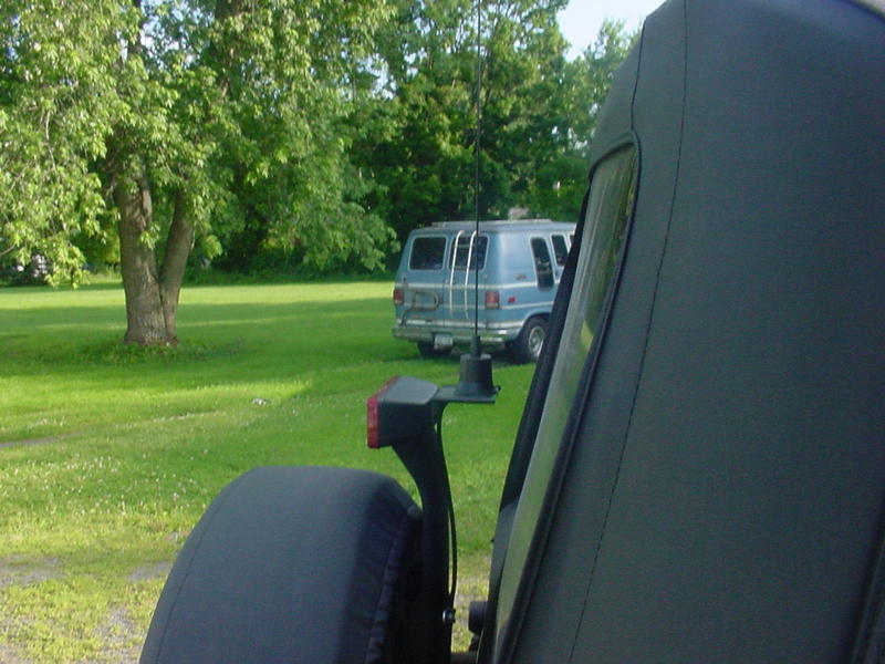

Old Jun 7, 2012 | 01:07 AM
kb2fzq's Avatar
Posts: 15
From: Glens Falls, N.Y.
Here's what it looks like...

Old Jun 15, 2012 | 01:00 AM
kb2fzq's Avatar
Posts: 15
Yeah, you guys were right...it was a cool looking little antenna, but...no gain, so there's a Larsen NMO-150B 3db gain 5/8 wave on the back now, much better....rfconcepts 2-30 amp goes in next...

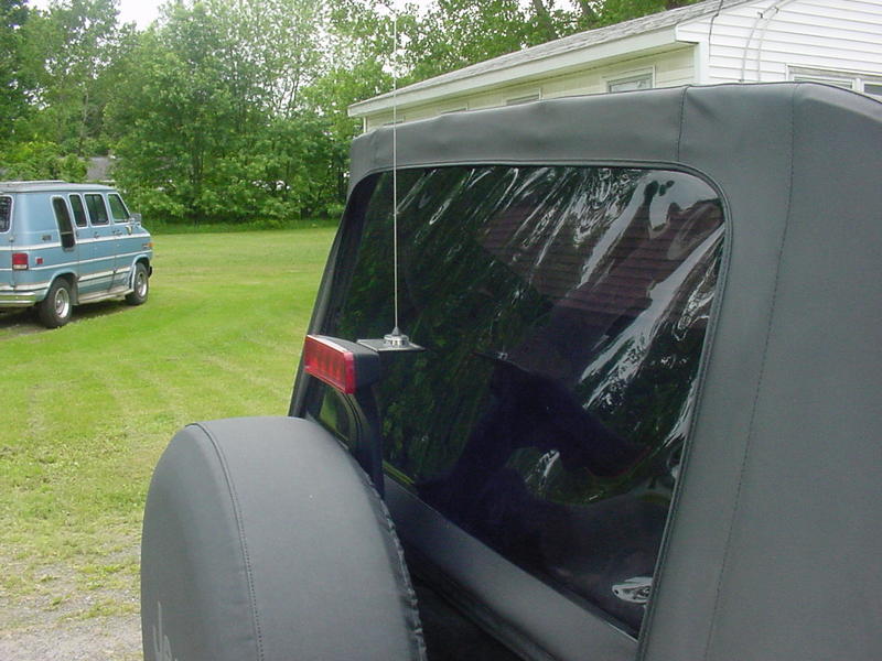

Old Jun 29, 2012 | 12:38 AM
kb2fzq's Avatar
Posts: 15
The Larsen NMO-150B
