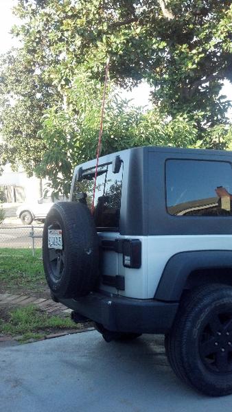

Firestik FireFly Antenna
As for the best Antenna for actual off-road use I would say the Firestik FireFly Antenna. It will have FL in the name if it is a firefly. Don't confused the firefly with firestiks other models that are much more ridged and require a spring . It's very flexible (and doesn't need a spring), Light weight, More top wound than than the more common Firestick II. It also gives you about a mile better range then the super flexible Wilson Flex. The firefly comes in 3' and 4' lengths. According to "Right Channel Radio's" you can expect the range to be
3' Length: 3 to 4 miles
4' Length: 4 to 6 miles
I've got the 3' mounted to the base of the spare. It is an 1" longer then my garage clearance and it creates no problem for the antenna or door frame. It has a tune-able tip screw for adjusting the SWR that is covered with a plastic cap. It's a good idea to put some hairspray in the cap after you have adjusted the antenna. That's the same way you keep on mountain bike grips.
Here is a firefly that comes standard with a cooltech ultramount shown below
If you decided to get something else at the local truck stop I would make sure it has a tune-able tip. These dudes are only about $20 and there is no reason to have to fiddle with trimming wire to adjust the SWR.
Good Luck
