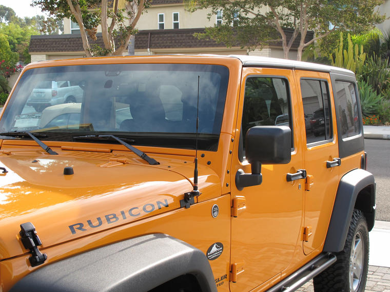

I have a similar antenna mount to the hood on the drivers side, and also have a rear antenna mount elevated above the tire.
As far as reception goes, the mount on the hood is the best.
I grounded my mount to an existing grounding bolt inside the engine compartment close to where the mount is. I had to leave extra length in the wires to the antenna and ground under the hood to allow the hood to be lifted up without stretching the wires.
BTW, my mount is more complicated since it mounts to the hood itself with set screws against spacers. That's why I ran a ground wire. I have taken it off so I don't get an unfaded patch of paint underneath it and now use the rear antennas and that works fine. But, the reception was better with the hood mount.
