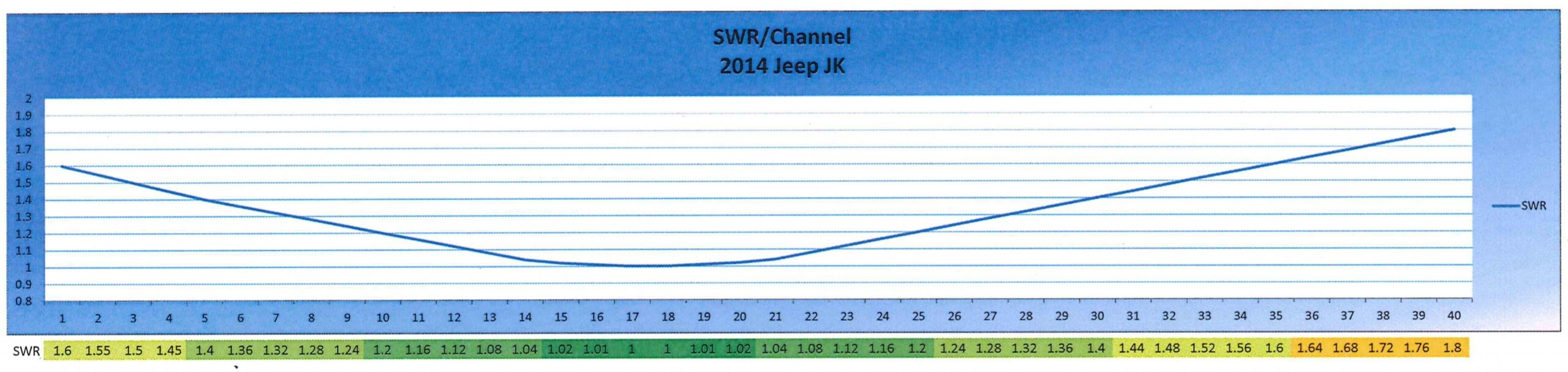

Originally Posted by MrKenmore
I have my two meter ham radio antenna there. Great mount. The spare tire location is horrible. Stay away from that area.
I always heard the spare tire location is horrible, but it seemed to be the most logical mounting location for me. My highest SWR on the channel spectrum is only 1.8:1.

For a CB, just leave it there. Make sure the mounting point is isolated properly from the antenna. I had a reading of about 3 initially. I drilled out the mounting point hole a bit to give additional clearance and the SWR went to 1.1.
