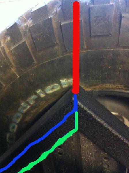

Ok so im looking at the Uniden 880 or 980 CB radios. Seem to have that modern look and look to be pretty decent radios from my understanding and reading. Main use is trail but would like to get most out my money and a radio. Opinions and differences of these two ?
Heres what i would like to do as far as mounting the antenna. Has anyone else done this before? I will drill through the top point of the tire carrier and use a shop vac to get the wires does to another hole at the pivot point and then into the Jeep from there. If i can't get the wires through the pivot point i will just drill another hole on the underside of it and just zip tie the wires to the underside of the tire carrier down.
Red= Antenna
Blue=1st planned route
Green=2nd planned route

Proper tuning with an Swr meter is the most important thing. Recommend not using a CB until tuned.

Uniden makes great radios and have really done a nice job with modernizing these models. The 880 is 40 channel CB with NOAA weather.
The 980 has same features but is also a side band radio. This means it has the normal 40 channels every other CB has but then you also get 40 upper and 40 lower side band channels.
If you are just looking for a trail radio I would stick with the 880. But if you are looking to get into CB as a hobby I would get the 980.
It sounds like you have a good plan to mount the antenna. You just need to make sure you have a stud and can get that securely mounted and still able to fish the wire inside the tube frame of the carrier.

For $20 more i will probably end up going with the 980, even though i probably wont need it. Yeah the mount for the antenna i was looking at some of the quick disconnects that are out there. I was only wanting to do this to keep people and their hands from stealing my antenna off the Jeep. I can always drill the hole and do a simple tack weld on the stud to ensure it wont move at all.
Ive been seeing the mounts that go to the stock tire carrier location. Have you or anyone that you know run this kind of bracket?
