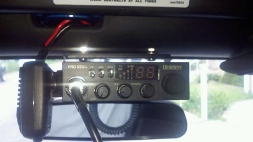

Hey everyone, newbie here. First time posting. Thought I'd give it a try! I have a uniden 520xl I mounted above the mirror. It's out of the way and looks good. I added a plug behind the radio so I can remove it when I need to. I made a flat bracket out of aluminum to mount to the overhead plastic piece, then mounted the radio bracket to it. I left just enough room between the radio and winshield for the antena cable and wires.

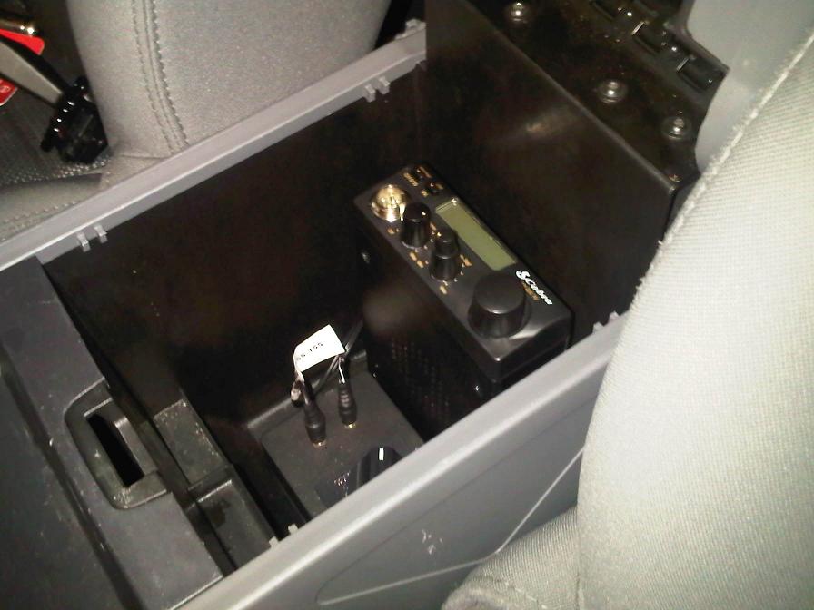

Mounted mine inside the console. Ran and external speaker and mounted it in the knee blocker lower pop off panel. I used an amplified speaker I bought from Passport that is used on the 9500CI. When you close the console the mic wire comes out the side nicely and the speaker is plenty loud and clear. Out of sight and works fine for me. The install is a little timely but turns out clean.Attachment 105008

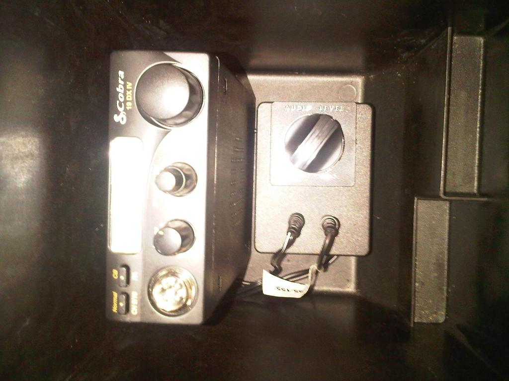

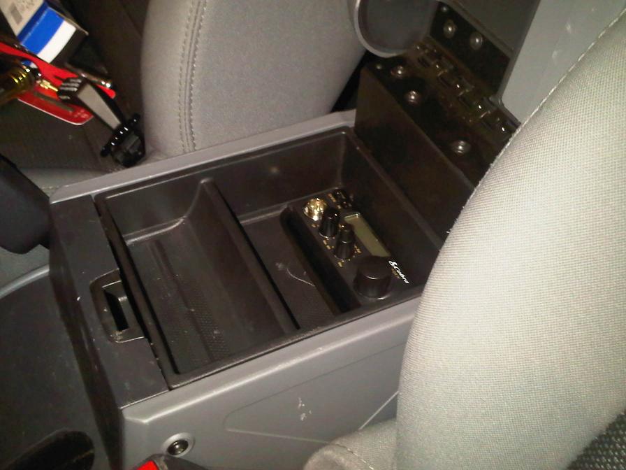

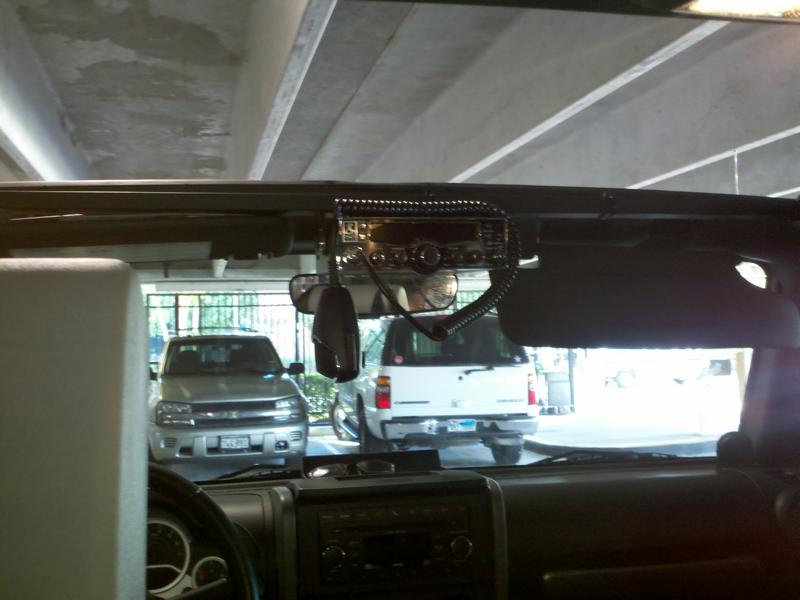

ID:	108277   Click image for larger version
ID:	108278   Click image for larger version
