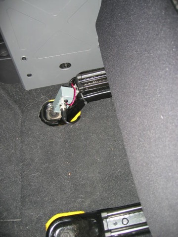

pics of console mounting and under seat junction box. the J-box is screwed to the leg of the passenger seat, power wire goes forward under the edge of the console. The mic slips into a normal mic bracket screwed to the front of the console, nearly invisible from outside. The hardest part of the install was drilling and tapping the seat leg; that's some hard, hard stuff.
Old Feb 17, 2008 | 11:39 AM
samc's Avatar
Joined: Nov 2007
Posts: 123
From: Albuquerque, NM
whoops. having trouble posting pics.

Not a bad idea. I like mine under the glove box, but that seems like a great alternative.
