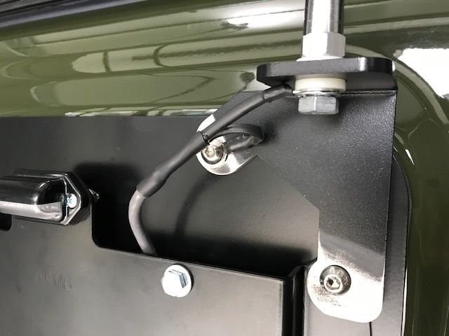

This is the best photo I have showing those plastic insulators / spacers on the CB Antenna mount ....
It is a two part affair - a plastic nut top and bottom, with a sleeve on one of the nuts so that the mounting bolt of the antenna does not touch the mounting bracket.
