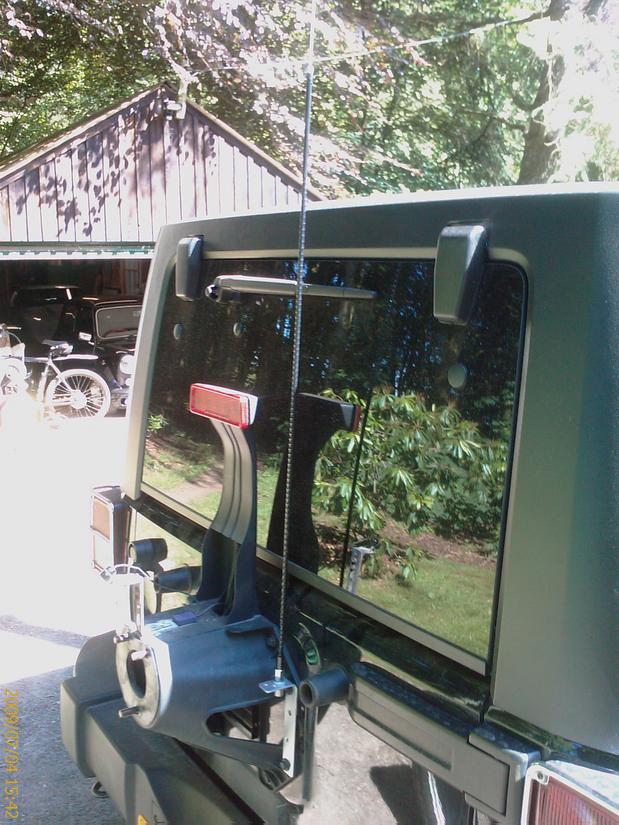

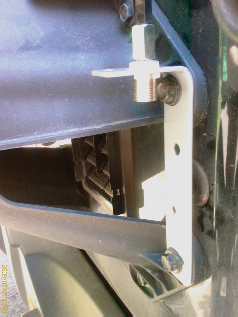

btw i just mounted my antenna. its sorta the same idea as the cooltech gatemount but cost nothin

Looks good guy. You may want to run another ground strap from the gate to the tub. Make a continuity check from your mount all the way to somewhere on the frame.
yup i will. i was hoping to get it all done today but my coaxail cable was too short and had soldered plugs so u couldnt get it through the rubber grommet. so i ordered a new one today
