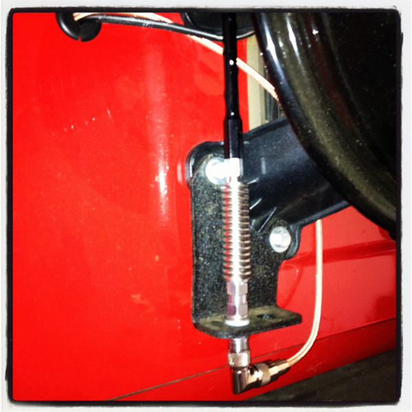

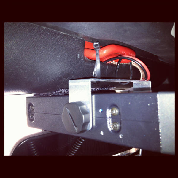

Look for a high quality coax, Firestik brand is very good, you can buy in many different lengths.
An 18' length was exactly enough to make it from my cb above my rear view mirror to the back of my tail gate
I used some brand of cable I found on Amazon for el cheapo...you can find literally ANYTHING you need for the setup on Amazon!
