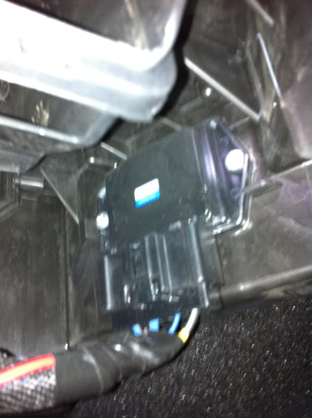

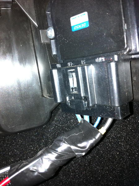

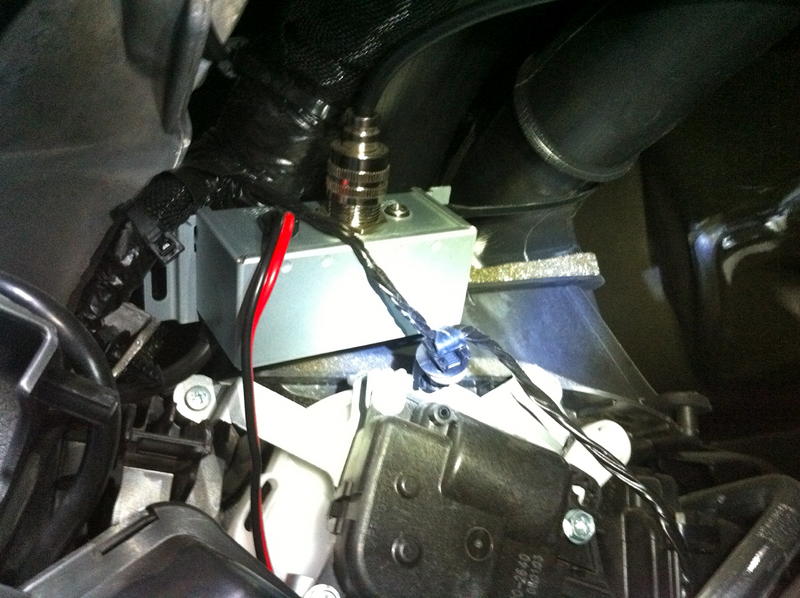

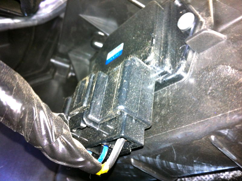

Ok, dug into the wiring tonight. Since a photo is a thousand words, here's a few to explain what I'm working with.

This is the module that I tied into. Not sure what it is, but my friend said it was a good option.

This is the CB module. Best place I could find for it. Any concerns with the heat?

Another photo of the module.
So, it powers up intermittently. It does have an inline fuse to help protect it. The ground ties into the module, not the body.
What's the word gents? Does it sound like a bad module? I receive the weather channel with some static, but no traffic at all on any of the channels. I let it cycle through scan for a few minutes and thought I would pick up some traffic, but nothing at all. Thanks again for all the help.
