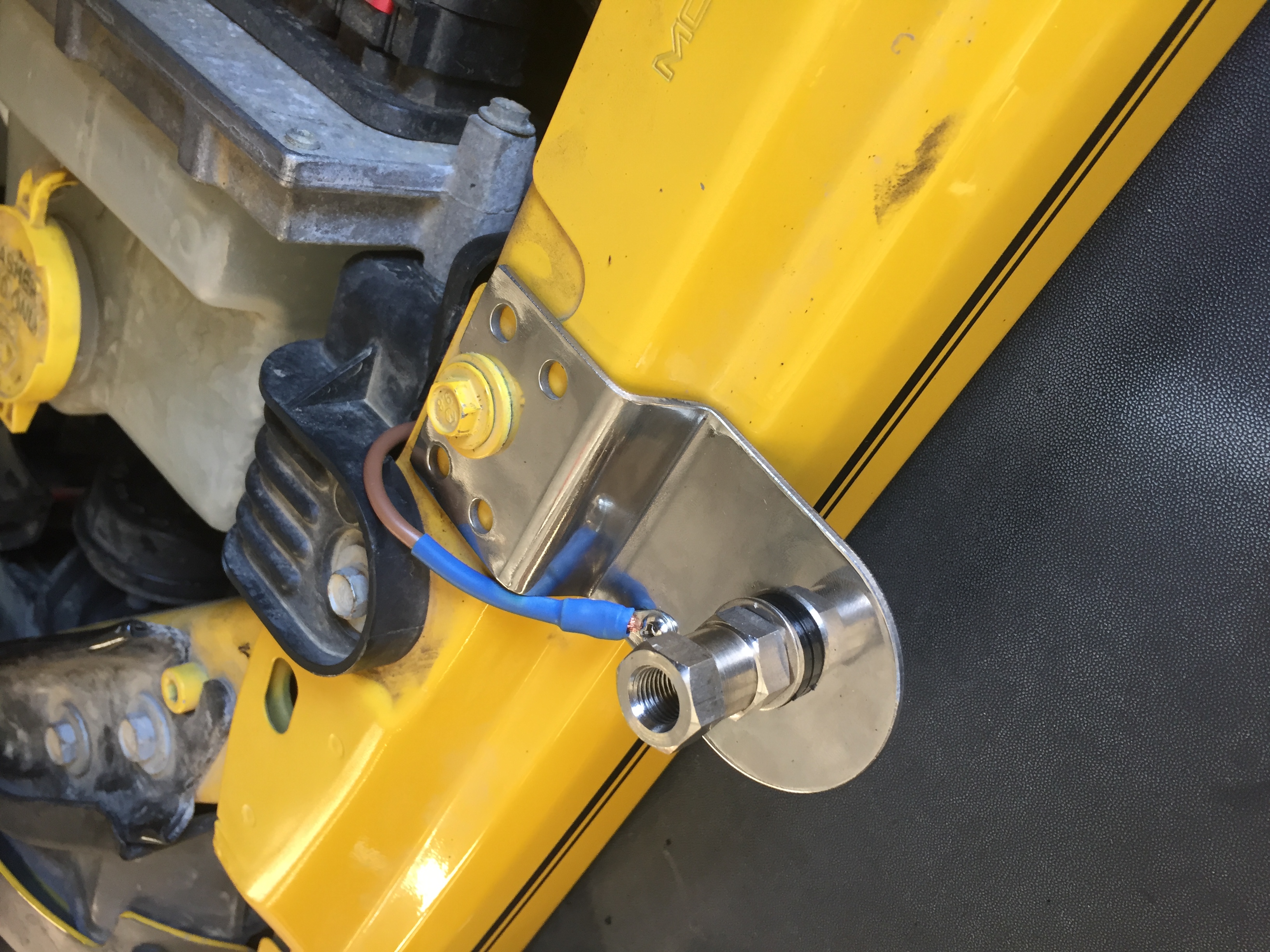

I am installing my front fender mount for my antenna. And I'm trying to locate the best ingress route for the cable. Does anyone have any input that runs a front fender mount

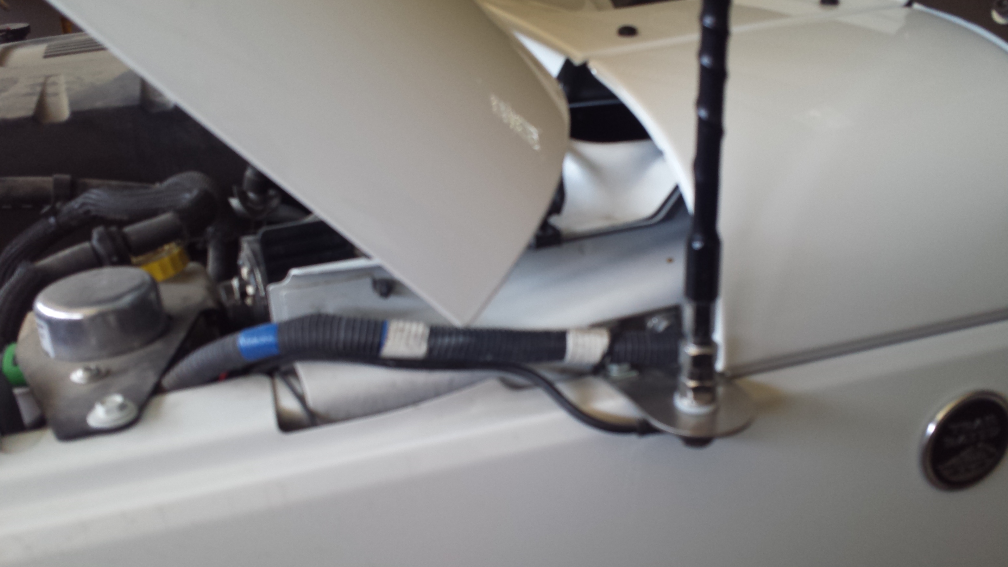

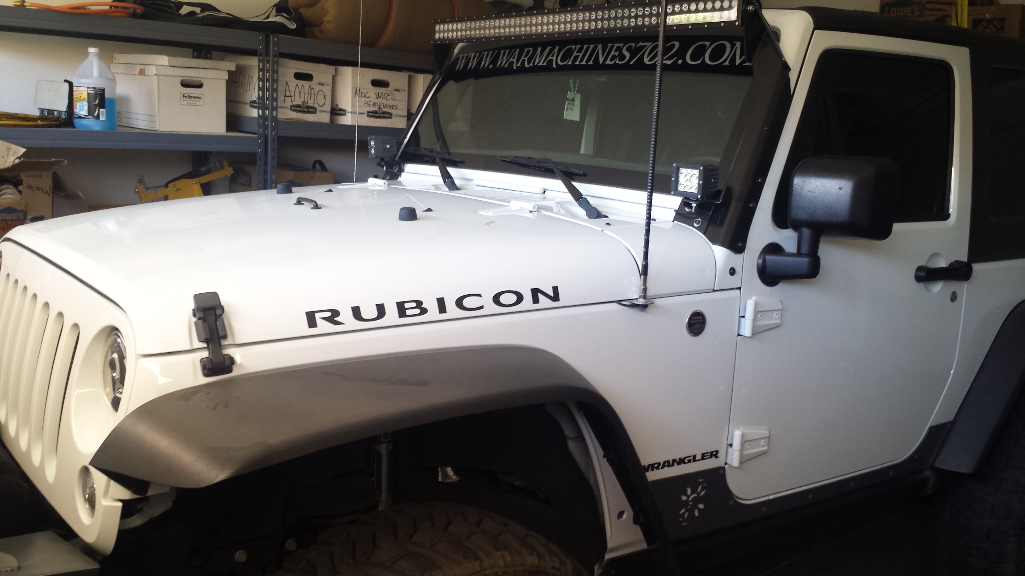

This is my fender mount .. I'll get a photo of the cable routing when I get home later.

I ended up about 10 mins after posting finding the foam holes on my own during exploration.

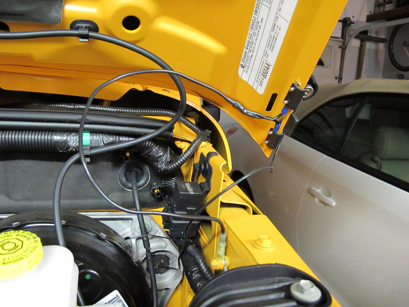

I ran mine through a large hole in the power brake booster mount at the firewall nearest the fender. There was just foam in it that was easy to cut a cross into. Since mine was mounted to the hood I brought a long length of cable in so the hood could be raised, you don't need to do that.
