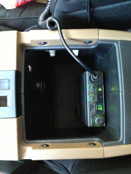

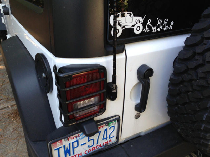

Installed the CB today. Tomorrow I'll go to an open area and hook an swr meter up. Happy with the mount. Check it out!
Compact CB in the console
Attachment 492111
Side mount antenna on rear.
Attachment 492112
Slick install. I have a similarly sized radio I was thinking of mounting the same. Your pics have just pushed me to do it tomorrow. Thanks!
And on a side note.............where did you get the decal on your back window in the 2nd pic?
Old Aug 31, 2013 | 03:26 AM
firecapt's Avatar
Posts: 237
From: Knightdale, NC
I got it from "runyoustickbastards.com.. But it appears he may have gone out of business. But just type in "run you stick bastarsds" and a lot of others have came up with similar designs.
