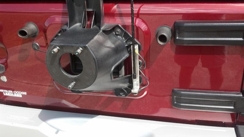

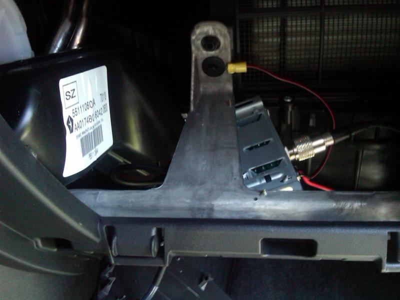

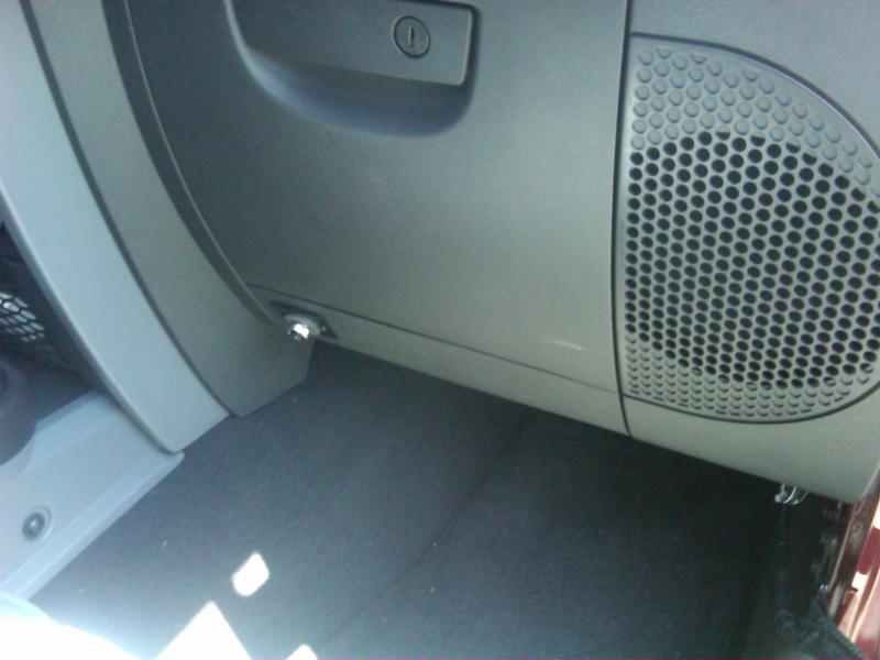

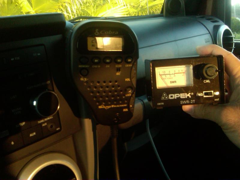

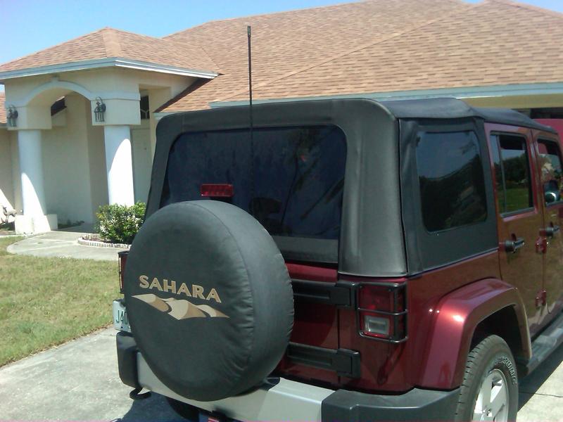

Seriously, I've been using a the Cobra 75 WX ST bought as a package from CoolTechLLC for over a year and a half. It required the least modification to mount. Only a hole for the plug in the kick plate under the glove box and a slot in the rubber grommet in the tail gate. The all-in-one kit included the mike mount, gate mount antenna (4'), wire and CB. The only thing else I needed was an SWR meter to tune the antenna. I got the OPEK SWR-2T from a trucker supply site. Works great.
Cool Tech LLC. CB All-in-One Kit
I use it on the trail but mostly for checking traffic/accidents on the interstate with truckers. It's saved me hours on I-4 between Tampa and Lakeland. If installed correctly, it has good range (about 5 miles) and ok sound quality without an external speaker. The 75 also has a weather radio channels.

Cobra 75 with firestick mounted almost identical to this post. The radio is behind the glove box. The antenna bracket is a cheap piece of alum flat bar from Lowes.

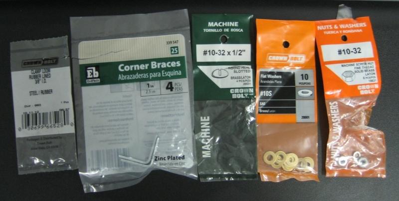

The L braces should be on the outside of the 3/8" clamp on this picture for a much tighter fit.
I posted this before but It seems that it will go with the topic
This mount will work with the new 2011/2012 hardtop that uses the footman loop. I copied this idea from someone who copied the idea(LINK-> So where have you been mounting the CB's? ). I got everything that I needed to do this mount for a Uniden 520 at Home Depot for about $10. This should work with almost any CB if it is not too deep. It works with the 2012 hardtop. It leaves the back of the radio about 2" to the windshield. I might have to get a right angle adapter for the antenna cable.
The insulated clamps are in a box in the nuts and bolts row. 3/8" is the size you want. It is best to put the L brase on the outside of the clamp instead of being sandwiched in there. It will give you a much tighter fit and won't scratch the paint.
The 1" corner brace was in the row with hinges and gate locks. It is the perfect size. You can also put one or both of the L braces facing in to move the mount or get it to work better.
I had some 1/2" size 10 bolts lying around so I used them. As a bonus they are brass so they will not rust. You need 4 of them and washers and nuts. They were the right size to fit very snug through the corner brace.
I put a strip of "rubber foam weather seal" right on the top back of the radio where it touches the windshield panel. It is the stuff you can put around your doors at home to stop drafts. I forgot to take a picture of it. I think it will remove any noise or abrasion to the panel.
