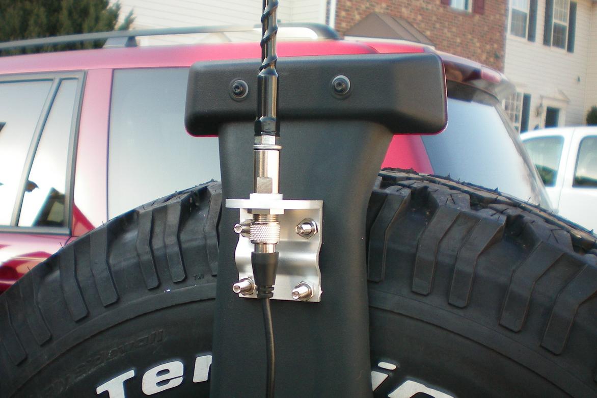

OK Guys, I am pleading ignorance here. I went to radio shack and bought one of their brand radios and antenna. I got the radio at a great price (40 bucks) because it was a clearance and they doubled the warranty. I got their brand antenna also. I installed the mount on the spare carrier and powered it by wiring direct to the battery. The problem is I don't hear anything. I can switch to the weather and hear it great, but i have sat there and flipped through every channel and hear no talking at all.
Any suggestions would be great.

check resistance between the antenna ground the mounting bracket and the tub of the jeep. if you have high resistance then you have a ground problem which is the first thing to check.

I get no static at all. When you say grounding strap....where do i attach it to the mounting bracket?

Sounds like some of the guys missed the part where you mentioned that the weather band is coming in great. With that said, I agree that the brake light mount is not the best place, along with the fact that the gate needs to be grounded to the tub. (get the ground strap at Napa) Search the threads to find a write up on how others have done it.
My antenna mount works great if you like the antenna where yours is mounted. You can see mine here: https://www.jk-forum.com/forums/jk-cb-ham-radios-128/sissy-bar-74589/ .
Once you get the antenna corrected, there are other tests to see if there is yet another reason why you're receive is poor.
