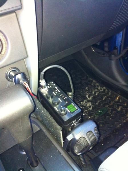

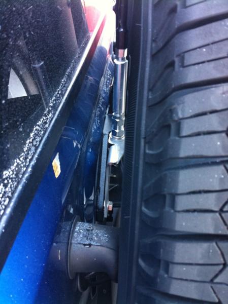

I'm running a Midland 1001Z on a custom mount to the passenger side of the console. I used the existing factory screw hole which makes installation an removal easy. I'm using a 4' firefly adjustable tip antenna. I'm getting 1.1 SWR readings. This set up is working well for me.

The antenna is on a quick disconnect an bracket I got from quadratec. It was a little expensive but worth it. I'm getting great range and even though I used the aux outlet for power, the setup is clean. No engine noise. I hope this helps !
