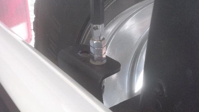

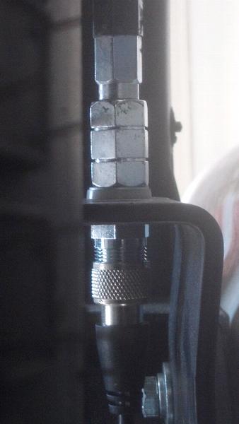

just wondering why i keep seeing a ground mentioned. when i purchased mine from CB store i was told adding a ground would only interfere with my reception. mine is mounted to spare tire carrier as well but i drilled it into the plastic for now up here in NY they dont have the mounting bracket that u all are using.havent tried it yet should i be worried with out a ground?
Old Feb 8, 2012 | 02:51 AM
evoviii2jk's Avatar
Posts: 323
From: Denver CO
Usually when you mount the stud for the antenna the bottom side of the metal bracket would be your ground. The top side should have the plastic washer on top of the mount, then the stud, then antenna, if that makes sense. I will post a pic when i get home
Old Feb 8, 2012 | 09:48 AM
evoviii2jk's Avatar
Posts: 323
From: Denver CO
OK snapped a couple pics of the mount. I have a 20' coax and a 3' firestik II. My SWR read at 1. I ground the black coating off the bottom of the teraflex mount for the ground. No ground wire needed this way.
