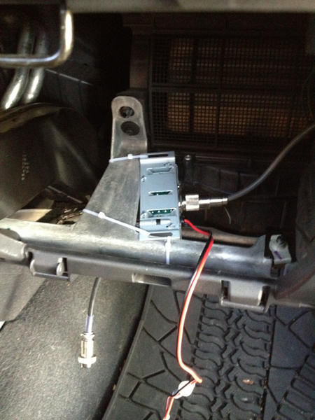

How did you drill the two holes to mount the box. Can you fit a regular drill in there, I notice the bottom panel dosen't remove anymore.

I just zip tied the box under the glove box. No need to drill it down

From: Pottstown, PA
Yea...not sure on the new interior how you'd get to it with a drill but if I remember right, on my '07 I drilled from underneath and used a few self tapping screws to mount the box to the glove box bracket as shown. I have seen plenty of people zip-tie but I opted to screw it down.
Ditto. I used a piece of industrial Velcro first and then decided two zip ties would provide even more stability. Works perfectly.

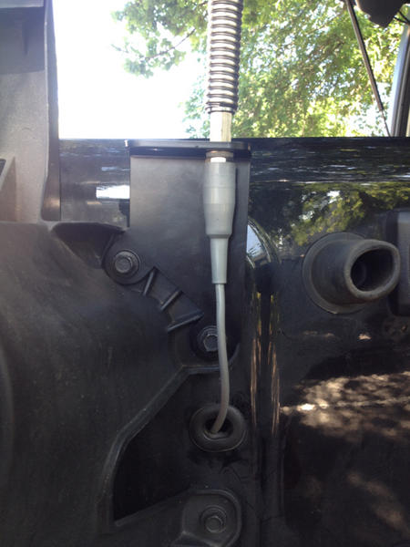

Here are some pics of how I mounted mine. Only the 2 screws for the mic clip are the only thing I had to cut or screw into the dash. I ran the coax into the tailgate an under the carpet until the door trim and ran it all the way to the box. 18ft was a perfect fit.
