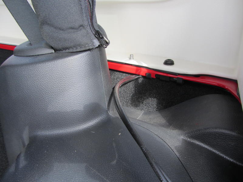

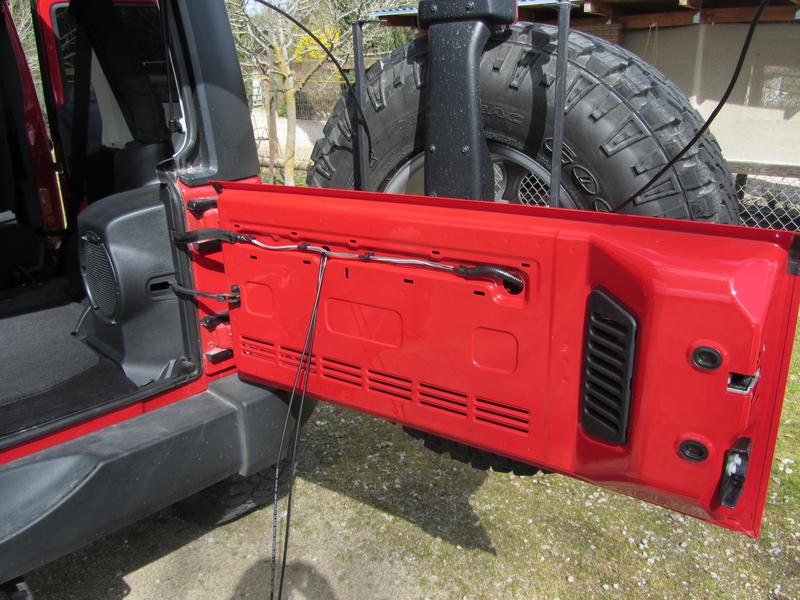

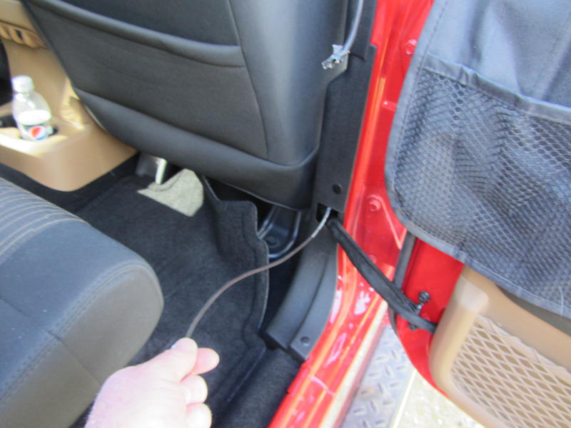

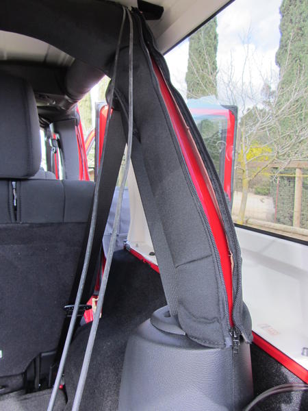

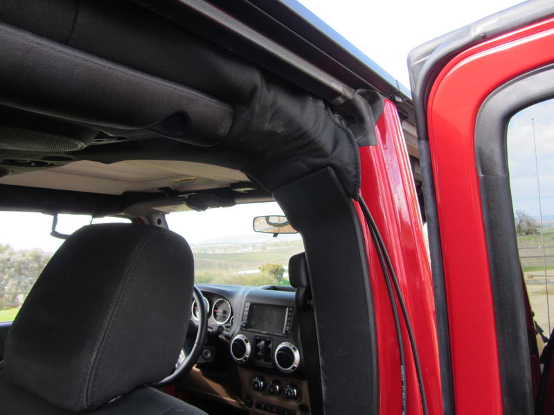

I ran two lines of RG58 from the tailgate, under the trim on the passenger side, then up and under the roll bar pad. One of the lines was run to a radio under the drivers seat by coming down from the roll bar under the plastic trim, then under the carpet. The other line continued under the roll bar pad until it gets the the windshield; then it was routed out along an ARR bar where the second rig was mounted.
As you can see, I unzipped the one piece of padding, and from there just pushed the RG58 through the padding until it got to the area above the passenger seat. From there you can pull the excess cable out and re-insert it at that point to get it through the remaining pad up to the windshield area (then conceal behind the trim to get to the dash.

Installed today. Ran all the way to windshield along roll bars inside roll bar cover/pad and down inside windshield trim to just under glove box. Unzipped at pillar between front and rear door. A wire hanger and some electrical tape did the rest. Takes a little time but easy. Nice, clean, invisible install.
Thanks
