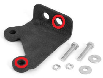

Ok, I picked up the rugged ridge mount as well, and there were a few things I had to do to get my SWR nice and low.
From what you've shown, you have the antenna mounted properly, but your bonding needs some work. Side note: bonding versus grounding, short version. Grounding is what you do to make sure DC current can get back to the battery. Bonding is what you do to connect the various parts of your vehicle into what's effectively a single unit for RF purposes.
Take some sandpaper and sand down to bare metal the areas on your mount I've marked in red:

You only need to do it on that one side in those two spots. Just make sure that the antenna stud and the washer makes good contact with the bracket.
If you're lucky, that should do the trick. I'm not running any bonding/grounding straps, and my SWR ranges from 1.2 to 1.5.

Thanks for the detailed reply. I sanded the mount down in the two locations you showed (down to bare metal) but no success. It only dropped my SWR from 2.5 range to 2.25.

Get a ohm-meter and see what the resistance is between the bottom part of the antenna stud and the stainless bolt that's in the hole you sanded. It should read zero or very nearly that. If it isn't, you probably need to do a little more sanding.
Next, measure the resistance from the bottom part of the antenna stud to the stainless bolt that's in the hole that still has the paint. It should read about the same, as it's getting it's connection through the skin of the tailgate door. This test is just to make sure that the bolt that you did sand the hole for is making a good electrical connection to the door.
If both of those read close to zero, then chances are you'll need to install a strap to bond the tailgate door to the tub. But just to make sure, I've a few questions:
