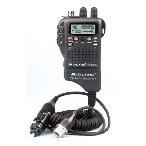

We use a Midland 75-822 CB that plugs into the 12 volt accessory outlet.
It's a nice little radio with pretty decent performance for what it is and has the NOAA weather stations built in.

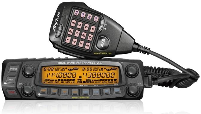

For long distance usage we run a 100 watt VHF/UHF dual band ham radio Rig with remote head for a clean installation.

The Midland 75-822 also comes with a removable battery pack for mobile use.

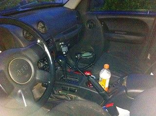

Last photo: This is our Rig setup with a goose neck mount in our previous Jeep Liberty.
