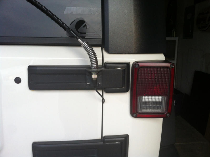

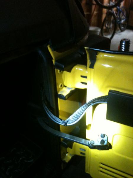

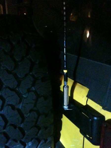

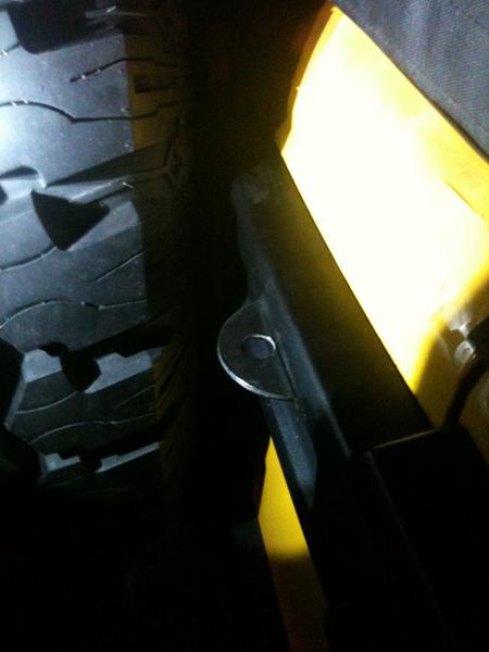

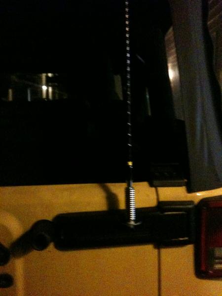

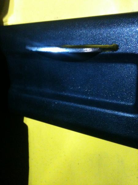

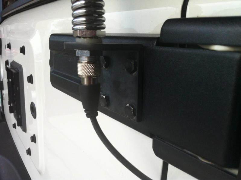

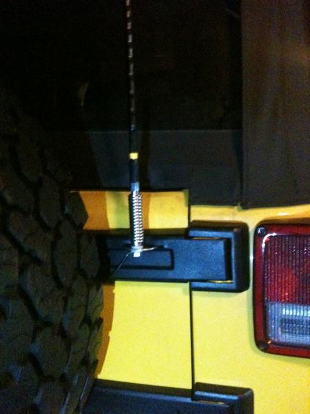

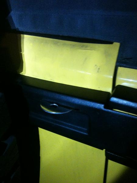

Hi guys,
I was trying to figure out the best solution for a CB antenna and came to the conclusion that an NGP Antenna was the best solution.
Here is my install with nothing more than a modified FireStick "3-way" mount.

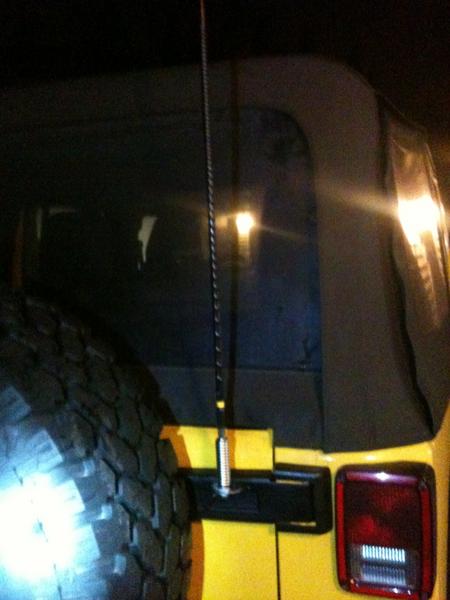

Default More pics.

Looks awesome...clean tight factory look...where did you get that mount or how did you make it...I want one!
The "3-way mount" came with the Antenna. I pulled the top tailgate hinge cover. Measured the space I had to work with and cut the mount to size. Then drilled out the hole to fit the bolt that passes thru it into the tailgate and it was done. :-)
Then slotted the plastic cover.
I bought this kit - nothing else needed. Period.
Model: FG3-648-B w/3ft antenna $62.99 (MSRP*)
Ran the cable thru the tire bumper grommet and up thru the roll bar covers.
