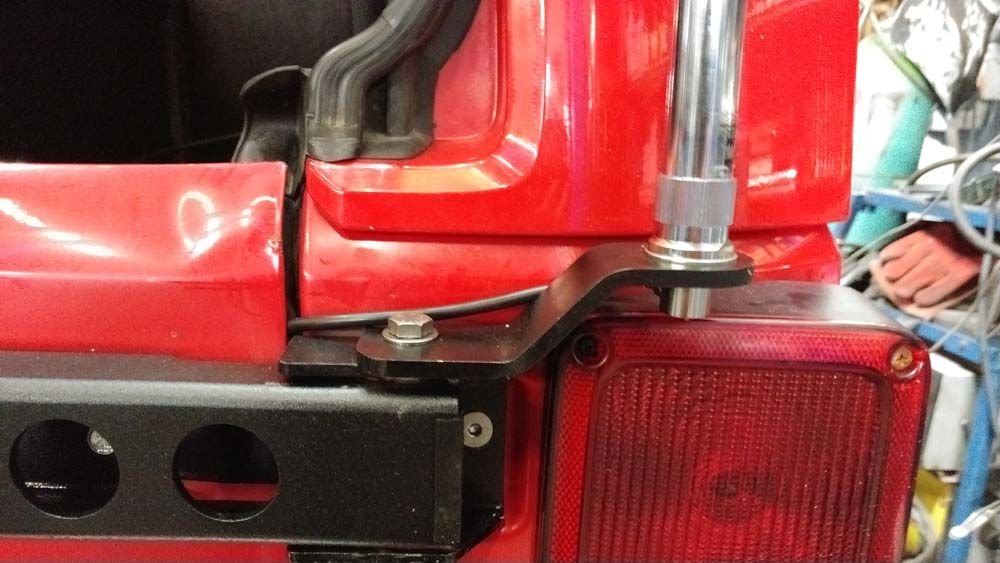

Antennas are another part of the equation, longer (wavelength eg 1/2 wave, 5/8th etc) + height will also play a factor in range. Personally not a fan of the spare tire mount antennas because the SWR (match) of the setup can be adversely affected by the way they are positioned. Aside from this there are a lot of different types of antennas on the market, for example magnet mount K40's granted with our Jeeps they won't stick to the roof which is the ideal spot or some of the top loaded fibreglass whips. So a good antenna in a good location with good SWR can make quite a difference in range for CB. On my Jeep I was lucky to have the Morryde tailgate hinges which allowed me to have a custom made bracket made to fit on the hinge. The advantage is that this gets the antenna away from the tire/rim.

'Not wanting to derail the thread - but nice antenna bracket !
Neville

Thanks, it was made by a friend. Strong enough to hold a 9' fibreglass whip though I have a multi band antenna on it currently. It will not bend at highway speeds. Fits perfectly on the Morryde tailgate hinge and keeps the antenna away from the spare. I bought one of the spare tire mount antenna mounts but immediately realized I was going to have problems with SWR due to where if sat behind the tire/rim. I didn't want to have to drill a hole on the body tub as we have use a lot of salt/brine on our roads and that would just rot out that spot. Was lucky that my used JK came with this hinge and not the stock one which I couldn't have modified to work. Just bought a JKU and the first thing I ordered was another Morryde heavy duty tailgate hinge kit.
