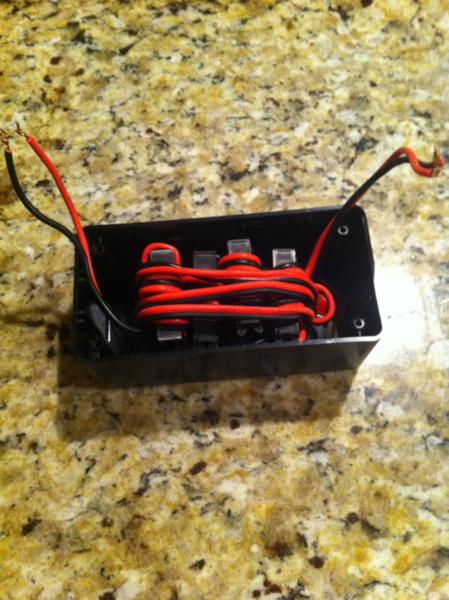

I actually used 4 of these to make my filter.
I'm also going to rerun my coax under the carpet instead of under the roll bar padding. Also ground the exhaust in two places yesterday. I need to pick up another strap from autozone for the hood and tailgate. They only had one of the flat ribbon style ground straps.
Here is my filter

Just wondering if you tried to snap a small one over the power lines first?

Most of my problems are coming in through the antenna not the power, I'm direct to the battery. The fuel pump is the main source of the noise. So I need to choke it out completely.

I'm pretty sure the fuel pump wires is what he was asking about, not your radio power leads. Did you just snap one over the lines to the fuel pump.
