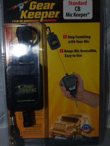

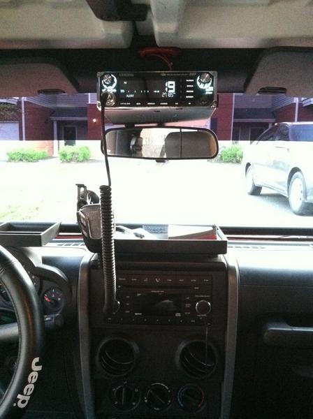

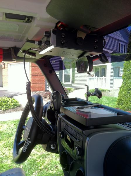

Might want to do a search for "Gear Keeper CB". I guess the company started out making retractables for scuba stuff and then branched out to other things. They have a hoop that goes over the button to hold the mic. From what I have read you can adjust the length you want it to hang at. You should be able to find one for less than $10. Here is some pictures.

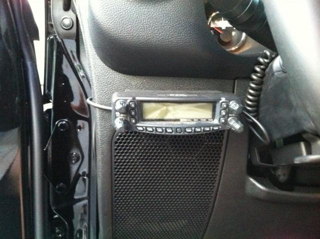

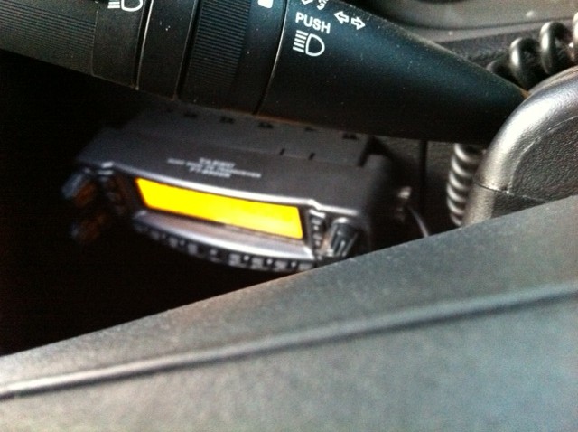

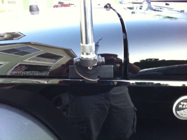

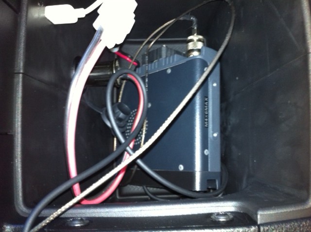

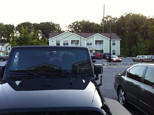

I've got some serious commo envy going on over your set up. I just got my 2012 JK and the weekend was my radio mounting project for it. Not a CB, HAM Yaesu FT-8900r and plan to get a CB for commo with non-HAMs on the trails.

Wanted to keep the radio out of sight of people just walking by, but still accessible to me when I am driving. The main radio unit will eventually go under my seat when I buy a longer power cord and mounting bracket.

Holy Cow, you got me beat by a mile. I just have the uniden 520 and no HAM licence yet. I found the pict with a search.

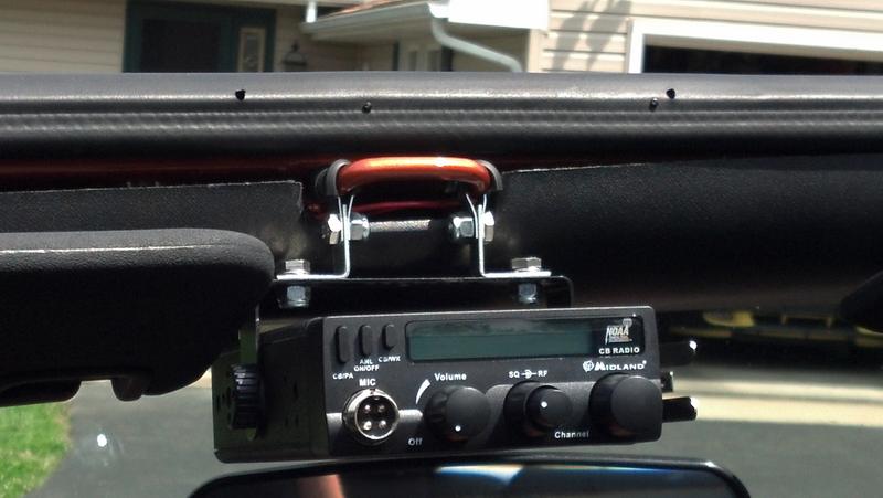

I just installed my Midland 1001LWX over the weekend above my rear view mirror. I used 1/4" insulated clamps. Had to put some muscle into bending the clamps to get the bolt through, but overall I think it is a clean install. Just need to run power to the unit. I am storing the mic in the console while not in use. Drove around the area a little with no issues of movement and the mic cord didn't hinder my view too much, however I don't use my rear view mirror that much.
