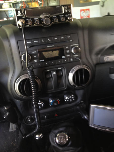

I mounted mine above the mirror. I have access to a sheet metal and a break so I made my own bracket.
To insure that I had a secure mount needed to screw it to the metal of the windshield frame.
I wish I would've have cut the panel I little straighter. But you can't really see it now that the radio is installed.
This basically what I started with.
And this is what it looks like now that it's installed

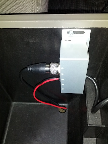

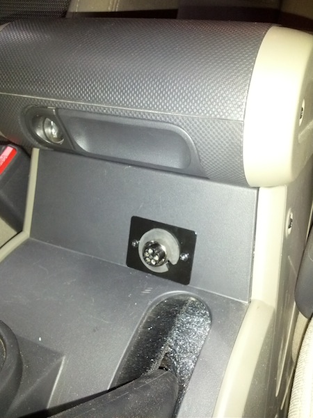

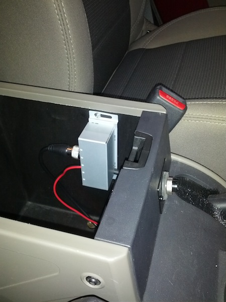

I chose to mount my Cobra 75 in the center console for several reasons. I wanted to be able to get the connection box in case I wanted to run a 3.5mm speaker cable to my radio or to an external speaker later. From what I understand the unit senses the cable and shuts off the internal speaker when a cable in plugged in, so if I mounted it under the console I would not be able to have a coice of using the internal or external speaker. Anyway, I like how the install turned out, let me know what you think.
Attachment 341245Attachment 341246Attachment 341247
I met up with another JK'r local to me who uses the same CB... he mentioned something about piping the external audio through his stereo. I forgot to ask him how he was doing that... the only thing I could figure is he connected the external speaker jack to his Auxiliary input for his stereo... since I'm not sure I could be wrong. But I thought I'd pass that idea on... if you're looking for an external speaker set up.
Old Jul 16, 2012 | 09:33 AM
  #216
jcalabria's Avatar
Posts: 11
From: Temecula, CA
That is exactly how I plan on doing it and the reason I have to be able to get to the control module is if I want to be able to use either the handset speaker or the Jeep audio. If the unit gets installed behind the dash or under the console you can't change your mind later because you can't unplug the 3.5mm jack from the control module. If my antenna shows up this week I should be able to let everyone know how it works out.

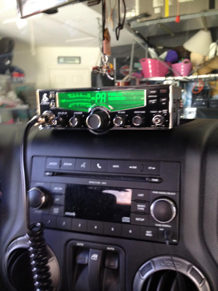

Just finished mine on my 2011... In the dash, had to fab a mount, the mount it came with wasn't deep enough to touch the bottom of the little cubby.

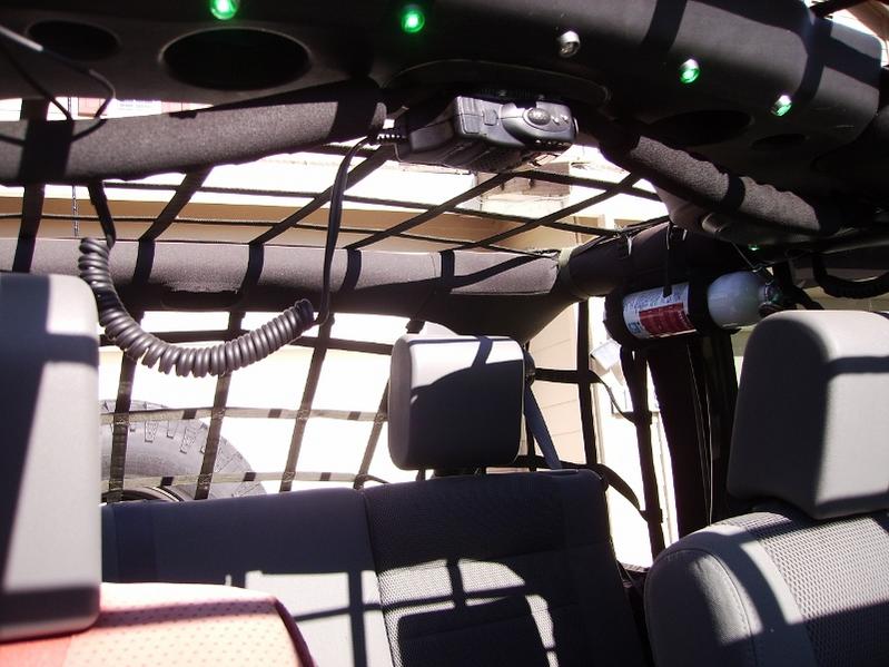

I have the Midland 75-822 and attached it to where my dome light used to be.
Name:	IMG_0022 (800x600).jpg
