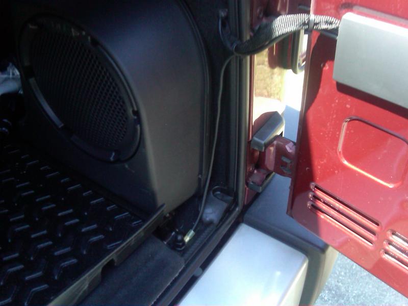

Sahara Lee's Avatar
Posts: 719
From: Lakeland, Florida
Default Gate mount grounding
My antenna ground is from a bolt on the antenna bracket (see black wire with yellow crimp loop on top bolt of inverted CoolTechLLC GateMount bracked) to the sub-woofer acorn nut (other end of black wire with another yellow crimp loop). Never an issue with grounding. Great SWR. (1=1.4, 20=1.0, 40=1.5)

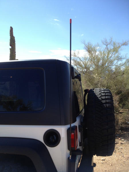

Old Jul 22, 2012 | 05:55 PM
Jeeping4Fun's Avatar
Posts: 85
From: Mesa, AZ
Here is my antenna mount. I use a cobra m#75 with a panavise mount and I think it works great. I am curious though as to what range it should operate at.
