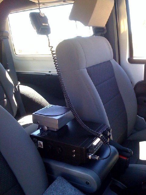

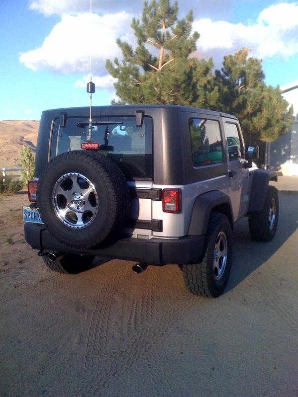

As you can see from my pic from my I-Phone, I mounted a RCI 250 watt AM/SSB radio on my console lid with heavy duty 2 X 4 strips of velcro, and then using the same velcro mounted the Cobra external speaker to the top of the radio, and a Gear Keeper mic holder mounted to the handle in the celling for the removable top. Last but not least mounted a 1200 watt amplifier for the radio on the cupholder mount on the rear of the console. The radio makes a nice place to rest my elbow when driving. Also mounted a Wilson 5000 antenna on a Firestick adjustable mount at the top of the collision light mount running 18 feet of RG8X coax inside through the tailgate to the amp then to radio.
Don't know if this helps anyone but radio is my "other" hobby so have done a lot of radio installs over the years so sometimes is quite a challenge.
Anyway......just my .02 cents rounded off to a buck
Larry

Default Posted wrong pic so here is another one
Meant to show a pic of the radio installed inside the Jeep, and posted one of the outside instead of but shows how the antenna is mounted kinda
Larry
