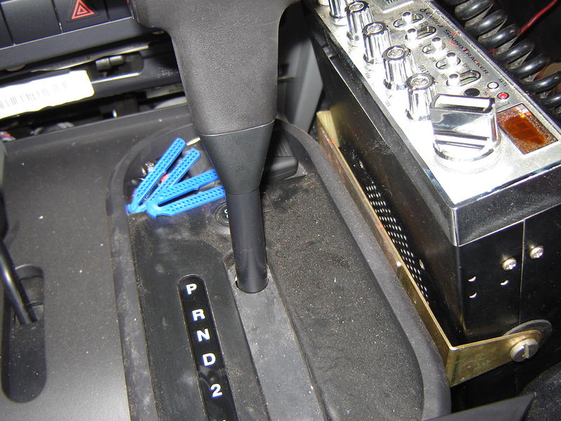

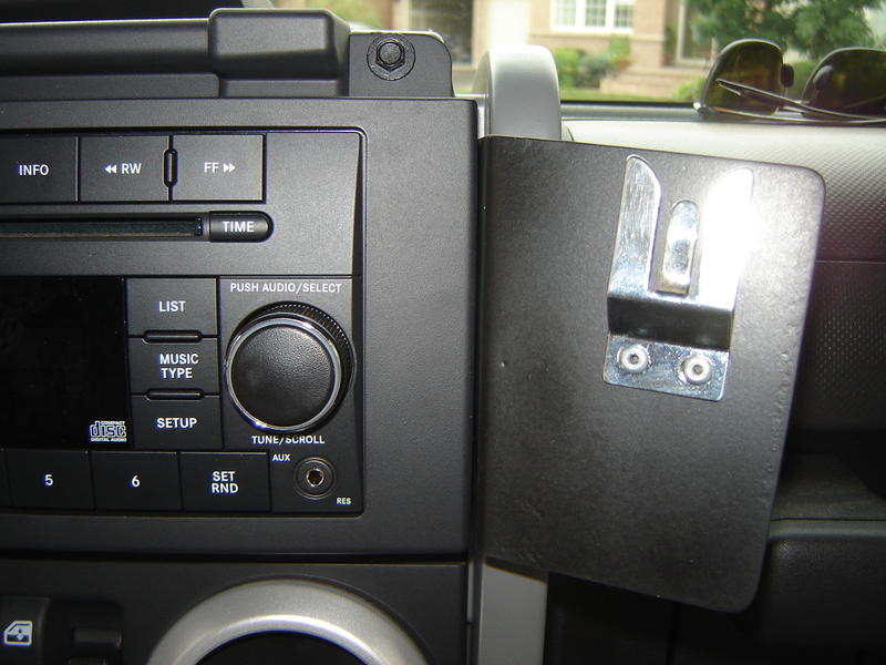

I mounted mine beside the console on the passenger side. Used the stock torx bolt that was there and fashioned a bracket to attach the CB mounting bracket to that holds secure. No movement, didn't have to drill any holes into the interior and no real impact on leg room on the pass side.
The mic holder is a homemade piece made out of steel plate that attaches behind the radio panel, keeps the mic within easy reach and out of the way as well.

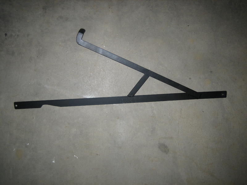

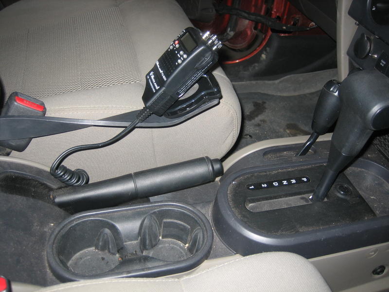

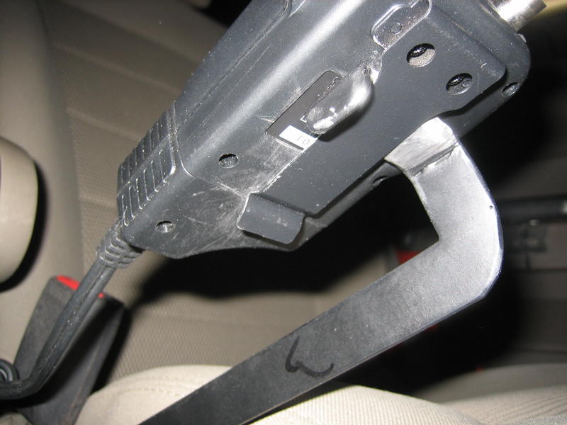

ID:	194018home built mount
Old Aug 10, 2011 | 06:42 PM
8000ft's Avatar
Joined: Mar 2009
Posts: 603
From: Tabernash,Co.
just realized that pictures 2 and 3 are using the proto type mount but you get the idea.
