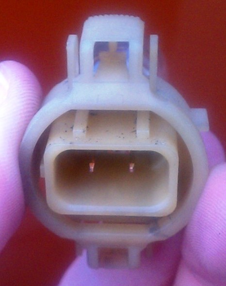

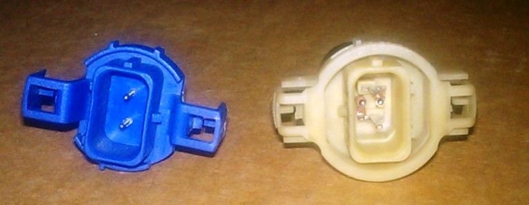

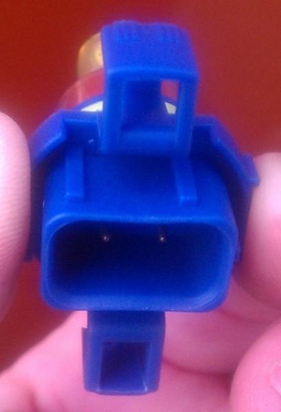

The pins are the same. Around the rectangle, you can see little bumps or guides so, when you plug them in, they go in the right way. Well, the H16 bulb is almost a perfect fit except for one of the little bumps is moved over so it doesn't fit the plug in the JK.

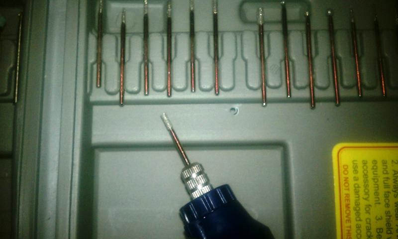

So, I went to Harbor F and bought a cheapo "dremel tool" that came with some attachments. Cost like $8.
I decided to use something that looked like it was for de-burring stuff. It worked great.

Here is the stock bulb. You can see the guides along the top of the rectangle. Notice how they are even distance from the ends.

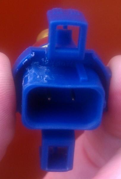

Here is the new H16 bulb. Notice how the guide on the left is closer to the side. It has to be removed for it to plug in.
About 15 seconds later with the dremel tool. Notice the guide on the left is gone.

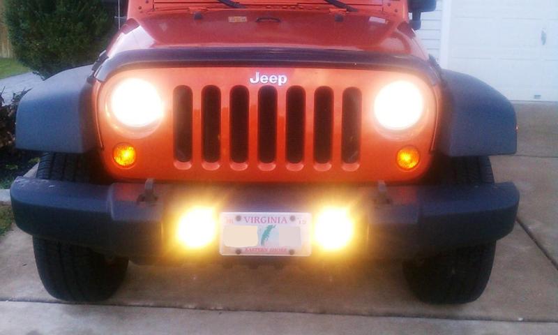

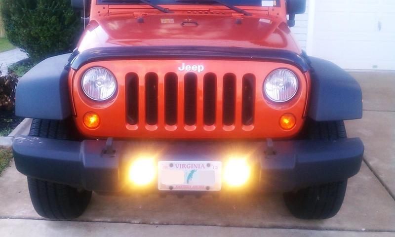

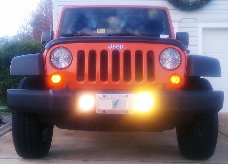

Ok, here are the final results. I am very happy with them.
The new bulb is on the driver side.
Both new bulbs.
Both new bulbs compared to the crappy stock head lights.
I hope this helps those of you that just want the option to buy a regular bulb that will fit your stock housing.

Hey guy that was a nice write-up and the new bulbs make a huge difference. I bought new SilverStar ones that I thought were for my '11 but was told they're not the right ones. Yours seem nice and bright. Have you gone out in foggy weather or at night and tested?

Yea, I drive in to work at 0330 hrs and get to see how bright they are. It was raining pretty hard yesterday and they are great. I think I need to adjust them. Work keeps getting in the way.
I have seen most of the other threads with folks installing HID's, or the Pilot 203W lights and others but don't have first hand experience with seeing any of those. But, these are definetly brighter and extremely easy to install. I am very happy with them.

Thanks, Sapper12b. I will try to get a night shot tomorrow morning before I go to work.

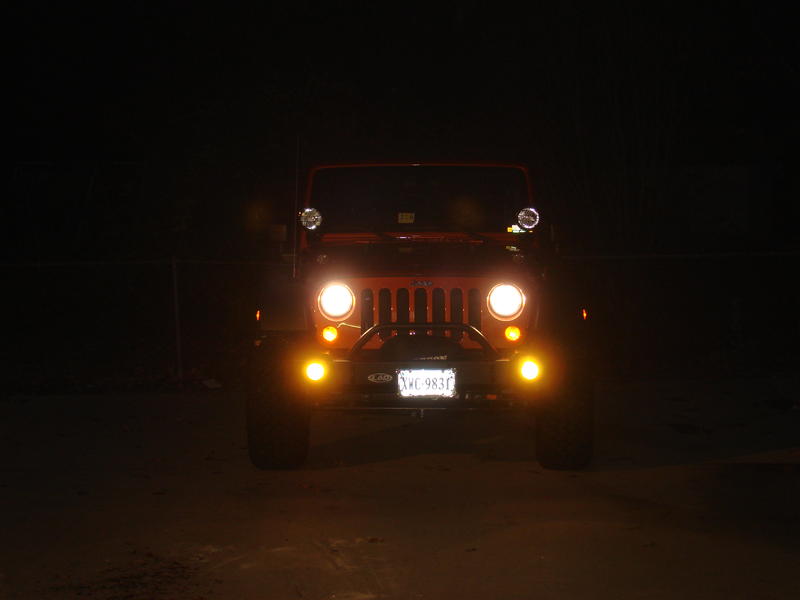

SWEET! We will definetly have to meet up and see the difference. Looks like the ones you got are about 500k more brighter than mine....I may have to order these too
Nice job on the write up!!
I added mine for referrence
