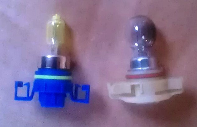

I took out the stock bulb on the right for a comparison.
Attachment 243957
The pins are the same. Around the rectangle, you can see little bumps or guides so, when you plug them in, they go in the right way. Well, the H16 bulb is almost a perfect fit except for one of the little bumps is moved over so it doesn't fit the plug in the JK.
Attachment 243958
Attachment 243957
Attachment 243958
