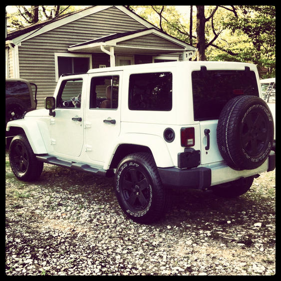

That is awesome news and thank you so much for the reply!
This is my first Wrangler and I hate that I haven't gotten one sooner I absolutely love it.
Best decision I've made in a long time lol
Old May 25, 2012 | 01:05 AM
  #30
Evo35's Avatar
Posts: 508
From: Northern, Virginia
Attachment 321092
I completely understand your enthusiasm. This is my first Jeep and I completely drive my wife crazy talking about it.
When you do the bulbs, feel free to post some pics and any thoughts on the process. Good luck.
EDIT: I completely forgot to say -- Nice looking rig. I like the rims.
