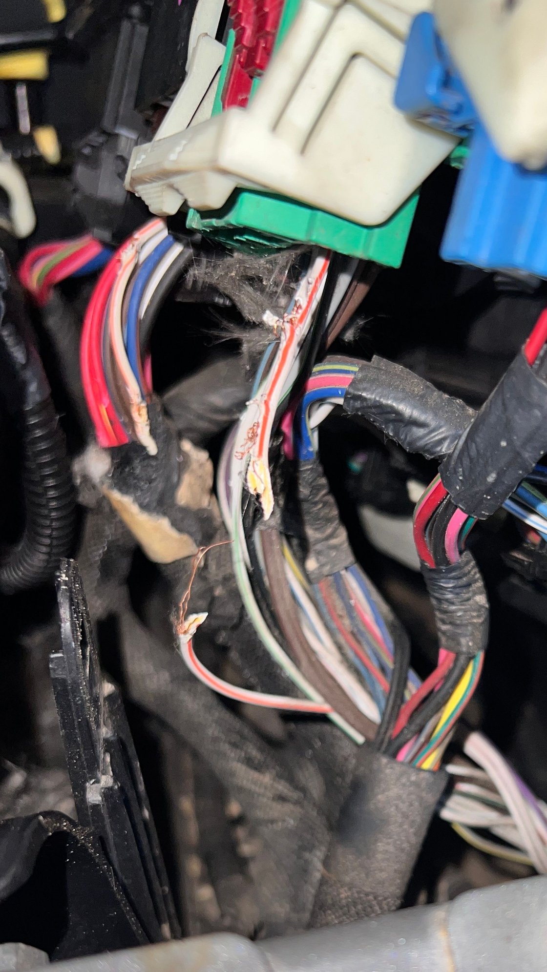

2015 JK, All stock lighting up to now.
passenger side low beam inop. Bought a new set of LED's from Quadratec and same problem. Checking wiring I found that I have 12 volts to the right pin in the factory harness left headlight connector with lights on low but zero on the right side connector comparable pin. I know the TIPM powers the headlights. Everything else works like it's supposed to....
BUT.
Will I hurt anything if I just jump the power from the left low beam wire across to the right side connector?

Probably, The CAN BUS probably will see excessive draw; not sure about this, but that system is sensitive. I'd run a code check and (I know its a long shot) look for possible rodent attack on wiring under the TIPM. Good Luck, update on your success.

I think the headlights have separate fuses for left/right as well. Check those out as well.

Default Found it
Thanks for the replies.
I decided to dig around a bit more onstead of band aid fix. I removed the TIPM and the first thing I saw was a white/orange wire broken and hanging down. I knew from the schematics that was the wire. And beside that one was another wht/org wire on the next plug that was rubbed through with strands showing. When the TIPM was either installed or removed and pit back in the yahoo that did it just mashed wires in and they just rubbed and broke. Hard to splice in but got them in and shrink wrapped. Fired it up and now all lights back to normal.
And, there are no fuses for the headlights. TIPM takes care all that.
Thanks again for the input.

Widget.. GOOD FOR YOU.. Excellent investigative/diagnostic work. Now the forum has a tread on this situation. Thanks for updating your finding and success.
You know, I think you may have nailed this one. There was evidence around the battery and tray of this. At first I thought that the firewall insulation may have deteriorated but it was too neatly placed, and some was between the battery and the TIPM. Also, the farthest right 2 plugs had evidence of damage to a couple of wires. Funny enough, the two wires that were actually broken, 1 in each bundle were wht/org. I wonder f there is something in the coloring of the insulation the those little critters like? We ARE inundated with brown squirrels.🙀
Wht/Org wires in two bundles appeared to be gnawed through.
