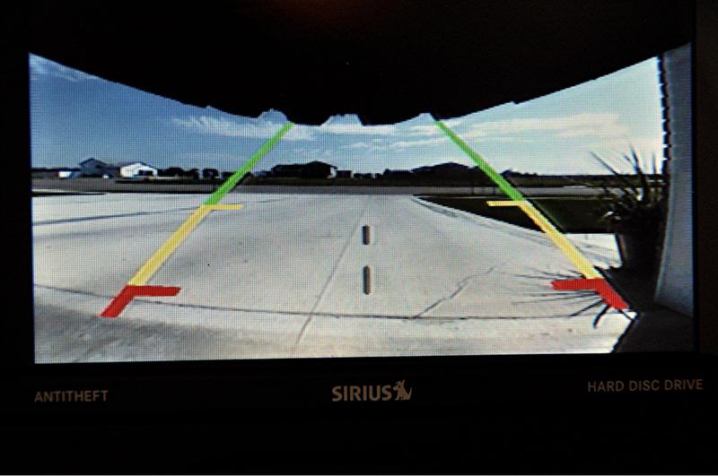

Name:	backup camera.jpg
ID:	360578I got it back and it works great. The picture I took is with my phone and is not very good but i'm very happy with it. The price, it was 550.00. Thats everything, the price of the camera and installation. You can see my tire on the top of the image!

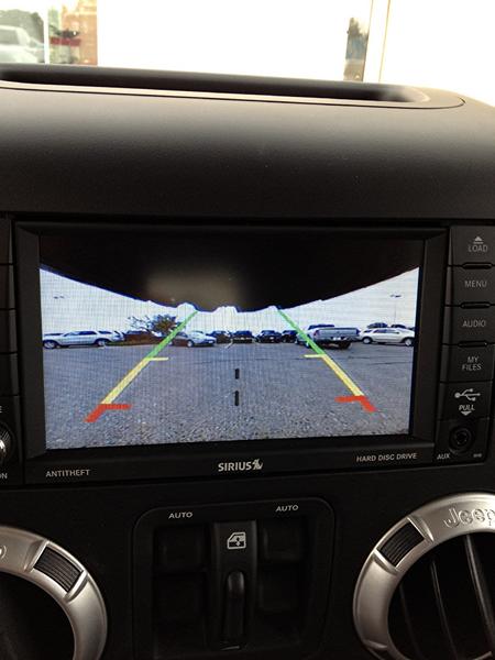

Here is a picture of the camera in the bumper and another of what the image looks like inside. The image is much better in person, cameras dont like taking pictures of video.
