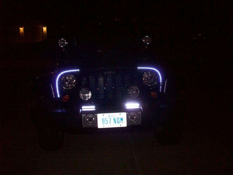

Just added some DRL - here they are at night - I'll take a daytime picture tomorrow.

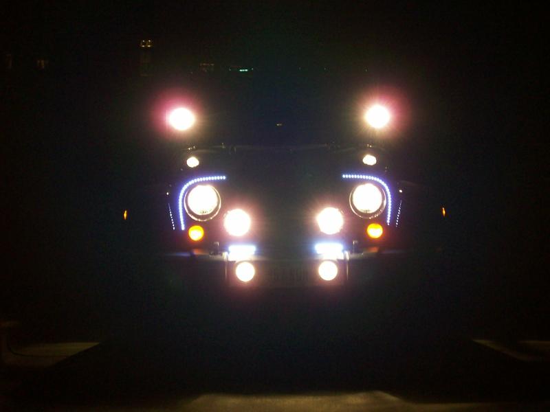

Second picture - think they can see me coming?
