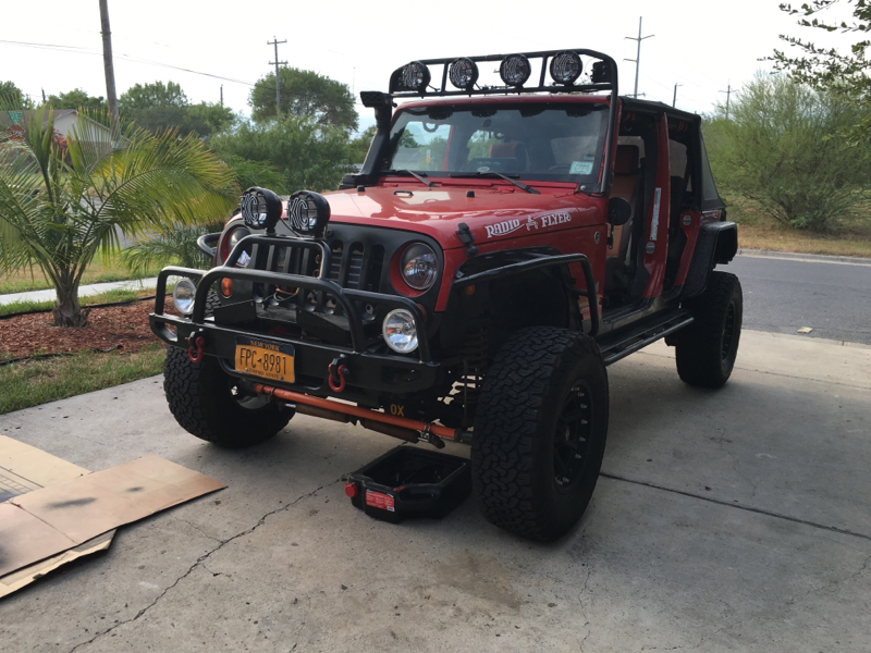

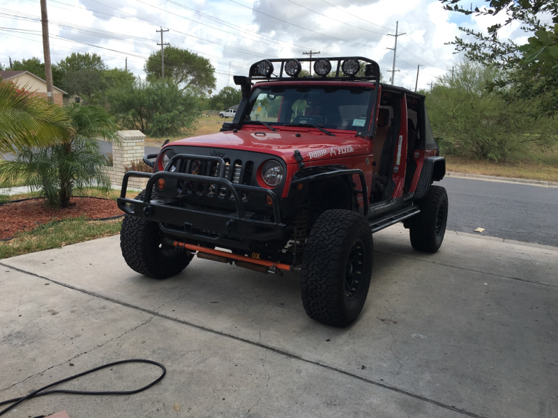

Ok I guess it's finally caused more issues then. At first it was just the air bag. But I didn't realize the scope of how much that stupid ribbon of wires i.e. Clock spring could cause so many issues. Does anyone know how I can go about finding out if mine is covered under warentee or recall? I'm the original owner and it's an 09 and do you think they'll deny due to mods and actually treating the jeep like a jeep
