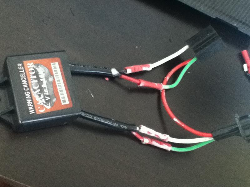

I had very slight flicker issue, and I found capacitor works for me. This is the link which I tried, https://www.jk-forum.com/forums/jk-e...-ideas-233873/
But your flicker is heavy, I don't know how its happend. maybe capacitor would work.Click image for larger version
But your flicker is heavy, I don't know how its happend. maybe capacitor would work.Attachment 332187
This is such a good idea too, I did this when I had flicker from my Rigid dually's in the stock fog spot using the stock switch and it cleared the flicker up right away. I wasn't sure about the headlight's though since they draw more current but you're proof that it works. Good Stuff.
