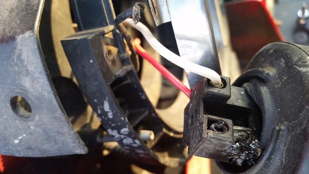

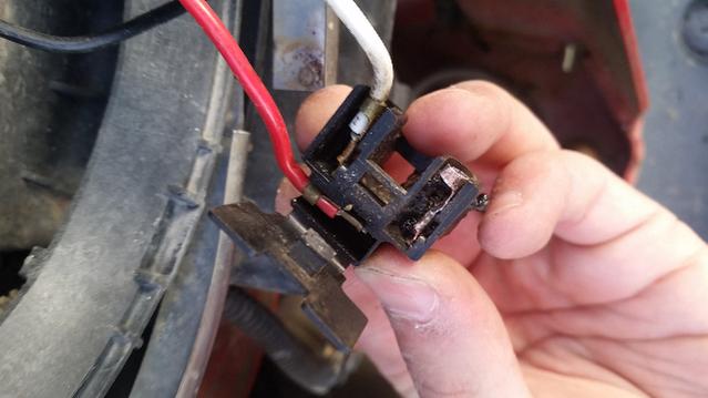

Ok so I bought a pair of the IPF after market headlights. Wanted that blue look but just turned out to be more problems than I expected.... First off the one side kept going out and I kept on taking a part the lights and plugging them back in and it just came back on randomly, the bulbs were fine and then it eventually started to get worse and worse untill the passenger side went out and the bulb was shot so I replaced it with h4s, which it states when you buy the headlights they say it will work like factory.... Clearly not and now I hardwired both and the driver side has no problems now the passenger side is out once again. Just took it apart and noticed that the black wire completely melted the connector to the bulb... And a bunch of forums said if you hardwire the IPF with the stock bulbs you'll be fine.. But here's a few pictures and does anyone know what the email address is that I can contact to send me a new set of lights or a refund. If it stated on the product description that it will work with factory specs, it should. Very poor product in my case nothing but problems..

So, in the picture (excuse me if I'm missing something you already said), what is the black wiring harness? IPF or stock?

The black wire is what melted off. And the black wire, along with the red and white wire are all apart of the IPF connector. When I first got the headlight I disconnected the stock light harness and plugged in the IPF harness, then I hardwired and now this. People said I should fix the problem but I'm wondering as to why it overheated and melted the bulb, plus where the bulb plugs into. I used the exact same bulbs as IPF ones also. Same watts/volts. But clearly there's a defect here. I messages quadratec, and nothing back yet.

OP, did you check the voltage? The system is PWM so should not send full voltage to the bulbs unless bypassed with a harness.
Strange to see it cook that connector.
Could it be overheating from the DRLs?
Any other electrical issues? Maybe it's more than just the lights.
