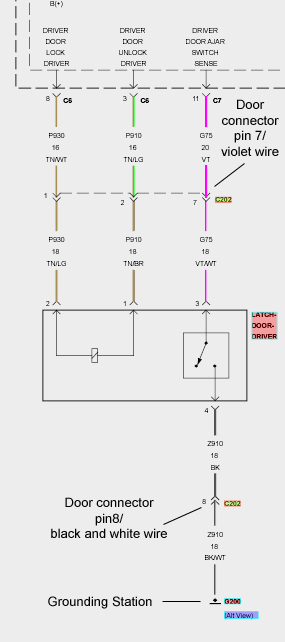

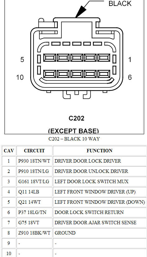

Looking at the diagram, it looks like all you have to do to stop the chime and keep your doors hooked up is ground pin 7 at the door connector or jump the wires that go to pin 7 and 8 together. I haven't tried it on my jeep though because I dont have power doors or windows, so I just leave the door connector unhooked. I attached images of the wiring diagram and the door connector if you would like to see for yourself.
