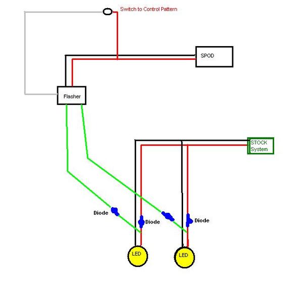

I recentry put some leds in the factory fogs. i will like to know if this looks right toy you guys to install the flasher while been able to keep them on the factory wiring. Click image for larger version

Any feedback will be appreciated

I guess you lost me with having your led's as flashers on the factory fog wiring......with an sPod wired in there.
What is it that you're trying to get at? Why the diodes? What's with the sPod feeding them power as well??

the reason i did this is because i want them on through the stock fog light location and i just want the flasher on the Spod.
I'm trying to achieve something similar to connecting some lights in reverse being activated by the reverse light or by an independent switch.

Are you trying to achieve flashing fog lights? Not sure I understand what is going on here.

Yes flashing fogs using the rigid flasher

The drawing you have above will do what you want. The diodes are to keep the current where intended and not back feeding the other circuit. Just make sure you install them in the correct direction or the lights no workie.
